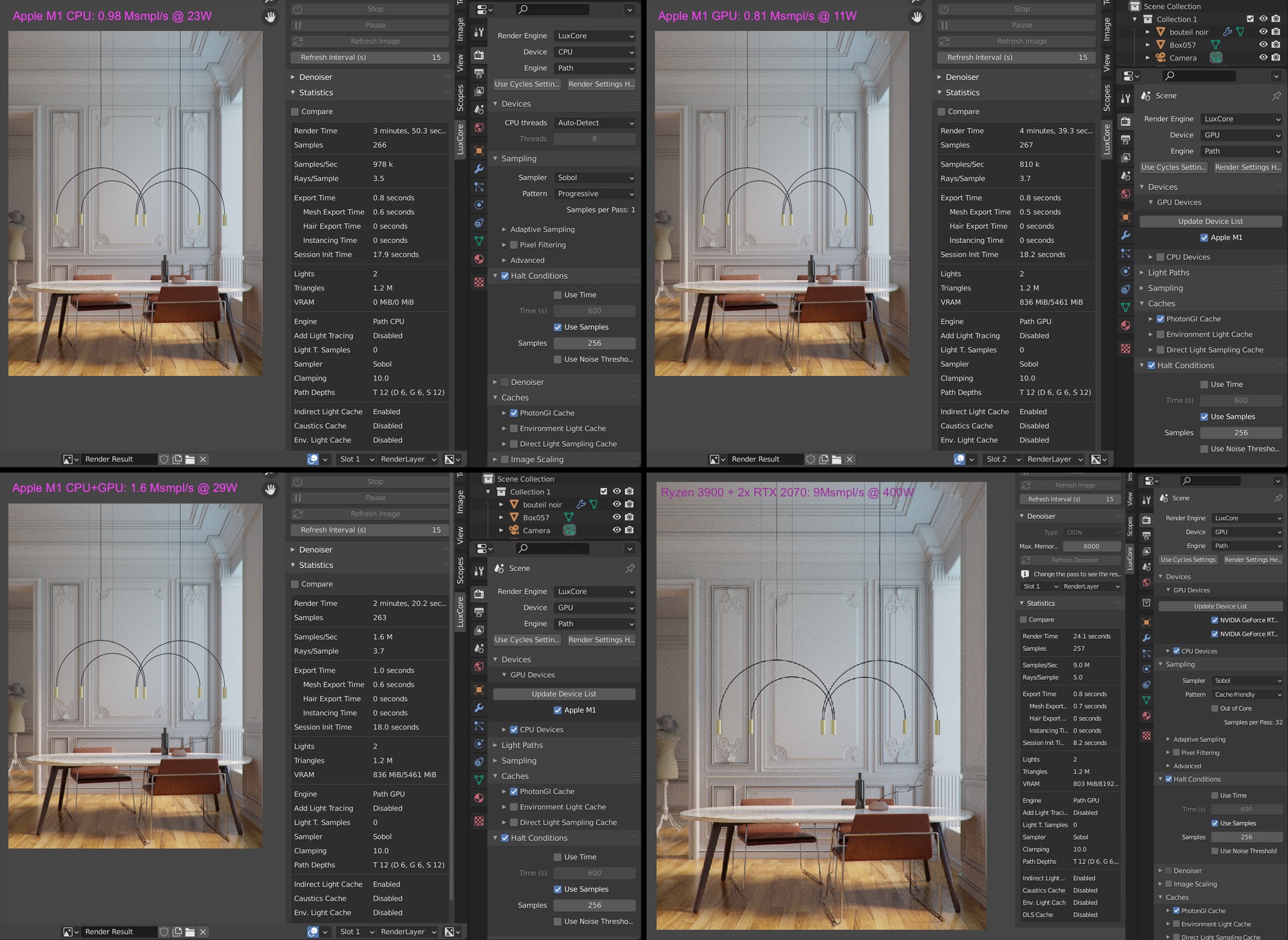

Bought a used MacBook Air M1, base version: 8CPU/7GPU cores, 8GB RAM+256GB SSD (modded with thermal pad).
Tested against Ryzen 3900X @ 65W TDP +2x RTX 2070 @ 130W TDP while measuring wall power in Watt.
Benchmark scene @ 256 samples, no denoiser, SOBOL progressive is faster for Mac while SOBOL cache friendly is better with Win PC.
While everyone is waiting for Cycles on Metal, LuxCore has already a working GPU solution which, running on OpenCL, might not even take a significant Rosetta toll which is ~20% for CPU render.

Very interesting to see render performance together with power consumption :!:
Thanks.
Re: Luxcore 2.1 Benchmark
So an M1 CPU is faster than a AMD 3900X (without even been natively compiled for ARM CPUs) :?:

Dade wrote: Mon Nov 01, 2021 2:57 pm So an M1 CPU is faster than a AMD 3900X (without even been natively compiled for ARM CPUs) :?:
Nope, the CPU is about half as fast natively, in LuxMark even worse because of ~20% Rosetta (X86 to ARM transl.) penalty.
LuxBench.pdf.zip
(18.54 KiB) Downloaded 2431 times
Above I have measured the average wall power during the main render (w/o scene setup) and multiplied with the render time to get energy amount used for the LuxBench render job disregarding time.
Here the M1 (CPU+GPU) is 1:1.67 vs Ryzen 3900 +2x RTX2070.
On Blenderartists I'm trying to get owners of the new M1 Pro/Max hardware to join in LuxCoreRender testing.
