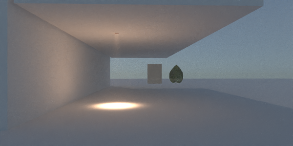

here i built a simplified scene of the problem.
volumetrics4.zip
(1.19 MiB) Downloaded 1111 times
Re: Volumetrics issues
daros wrote: Mon Oct 11, 2021 7:17 am here i built a simplified scene of the problem.
Your volume definitions are wrong:
1) Sun and Sky light sources are outside your "fog" box so they must not have the ".volume" definition as "fog".
2) you have various interior/exterior surface definitions as "fog". They have to be removed. You are mixing 2 different kind of approaches to volume definitions (define camera and light sources volumes Vs. define all interior/exterior volume definitions).
3) there was bug with not-NULL transparent surfaces when the interior and the exterior volumes are the same (your glossytranslucent leafs). Use the latest sources with the fix.

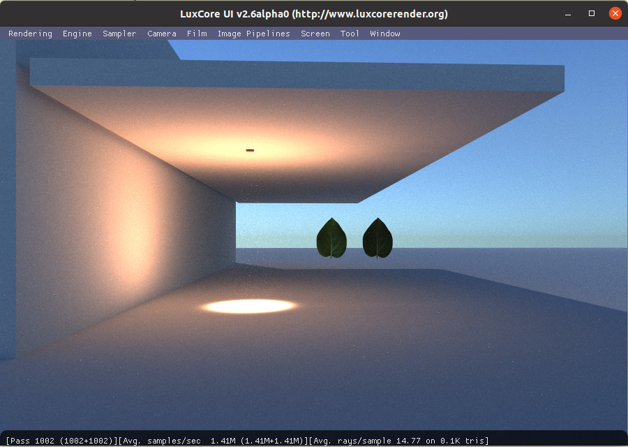

The attached scene works fine:
volumetrics4bis.zip
(1.2 MiB) Downloaded 1098 times

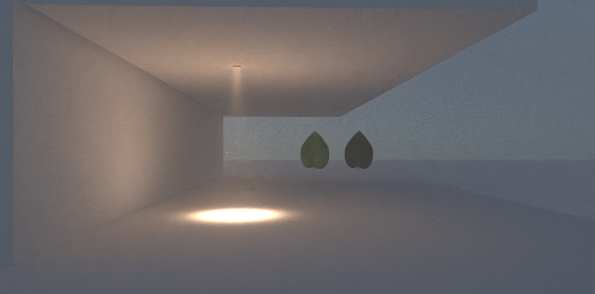

Hi, Dade. I can't see the light volume in your previous post. I thought it might be a problem with low samples, so I repeated the render:

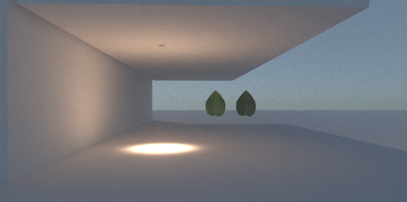

Then I analyzed what you said and decided to turn on the interior/exterior volume for the material that has the emitter on (I removed the comment in lines 402 and 403 in your zip)
scene.materials.89597_3.volume.interior = "envVolume"
scene.materials.89597_3.volume.exterior = "envVolume"
And it looks correct! I hope I did this correctly:

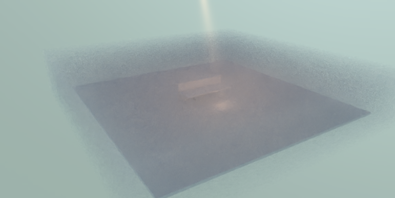

So from our tests, it looks like the light will produce volume if the volumetrics are assigned to the light source. If they are not assigned, we will not see the light volume. But what if the light source is outside the volume? The light volume should only be inside the fog, not outside.
bartek_zgo wrote: Tue Oct 12, 2021 8:03 am So from our tests, it looks like the light will produce volume if the volumetrics are assigned to the light source.
You have to assign light volumes according their placement: if a light is inside a volume (cone light) assign the volume, if the light is outside (sun and sky) don't).
Posts: 311
Hi, dade, thanks, in fact this is what we did on the last picture of Bartek's post. The problem is that the volumetric should not start at the light source but at the beginning of the fog cloud. Is there a way to obtain this?

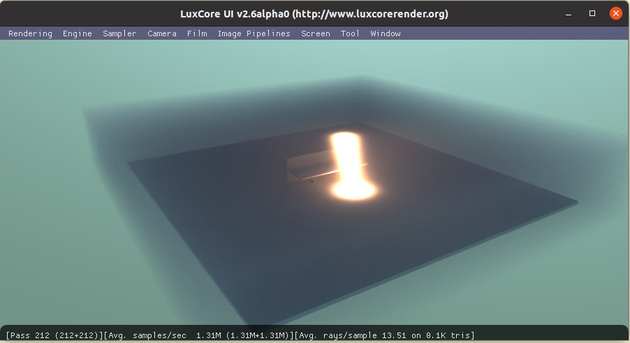

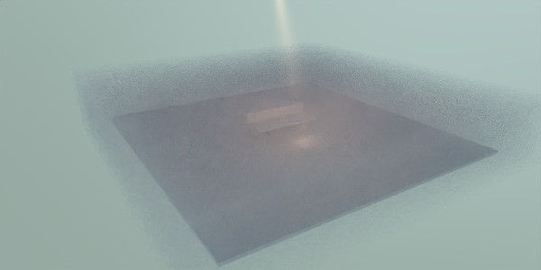

Hi Dade, in this scene we followed your advice however the problem persists... The light beam of the spot should start only wen the light intersects with the fog box. Instead it starts at the origin of the spot where there is not fog at all.
light_outside_fog.zip
(1.31 MiB) Downloaded 1120 times
daros wrote: Wed Oct 13, 2021 10:02 am Hi Dade, in this scene we followed your advice however the problem persists... The light beam of the spot should start only wen the light intersects with the fog box. Instead it starts at the origin of the spot where there is not fog at all.
You are still declaring the wrong volume for sun and sky:

And using wrong volume declaration for the disk light source too:
scene.materials.89671_1.type = "glossy2"
scene.materials.89671_1.kd = "0.3185468 0.1529262 0.06480328"
scene.materials.89671_1.ks = "0.05"
scene.materials.89671_1.uroughness = "0.0218"
scene.materials.89671_1.vroughness = "0.0218"
scene.materials.89671_1.ka = "0 0 0"
scene.materials.89671_1.d = "0"
scene.materials.89671_1.index = "0 0 0"
scene.materials.89671_1.multibounce = 0
scene.materials.89671_1.doublesided = 0
scene.materials.89671_1.transparency.shadow = 1 1 1
scene.materials.89671_1.id = 16776960
scene.materials.89671_1.emission.gain = 1 1 1
scene.materials.89671_1.emission.power = 1e+08
scene.materials.89671_1.emission.normalizebycolor = 1
scene.materials.89671_1.emission.efficency = 5.5
scene.materials.89671_1.emission.theta = 90
scene.materials.89671_1.emission.id = 0
scene.materials.89671_1.emission.importance = 1
scene.materials.89671_1.emission = "0.7835379 0.48515 0.2961383"
scene.materials.89671_1.emission.mapfile = "imagemap-00001.exr"
scene.materials.89671_1.colorspace = "nop"
scene.materials.89671_1.storage = "float"
scene.materials.89671_1.emission.temperature = -1
scene.materials.89671_1.emission.temperature.normalize = 0
scene.materials.89671_1.emission.directlightsampling.type = "AUTO"
scene.materials.89671_1.bumpsamplingdistance = 0.001
## REMOVE THIS:
scene.materials.89671_1.volume.interior = "envVolume"
scene.materials.89671_1.volume.exterior = "envVolume"
scene.materials.89671_1.visibility.indirect.diffuse.enable = 1
scene.materials.89671_1.visibility.indirect.glossy.enable = 1
scene.materials.89671_1.visibility.indirect.specular.enable = 1
scene.materials.89671_1.shadowcatcher.enable = 0
scene.materials.89671_1.shadowcatcher.onlyinfinitelights = 0
scene.materials.89671_1.photongi.enable = 1
scene.materials.89671_1.holdout.enable = 0
The 3 light sources are outside the "fog" box and they must have no volume assigned. It will than work fine:
