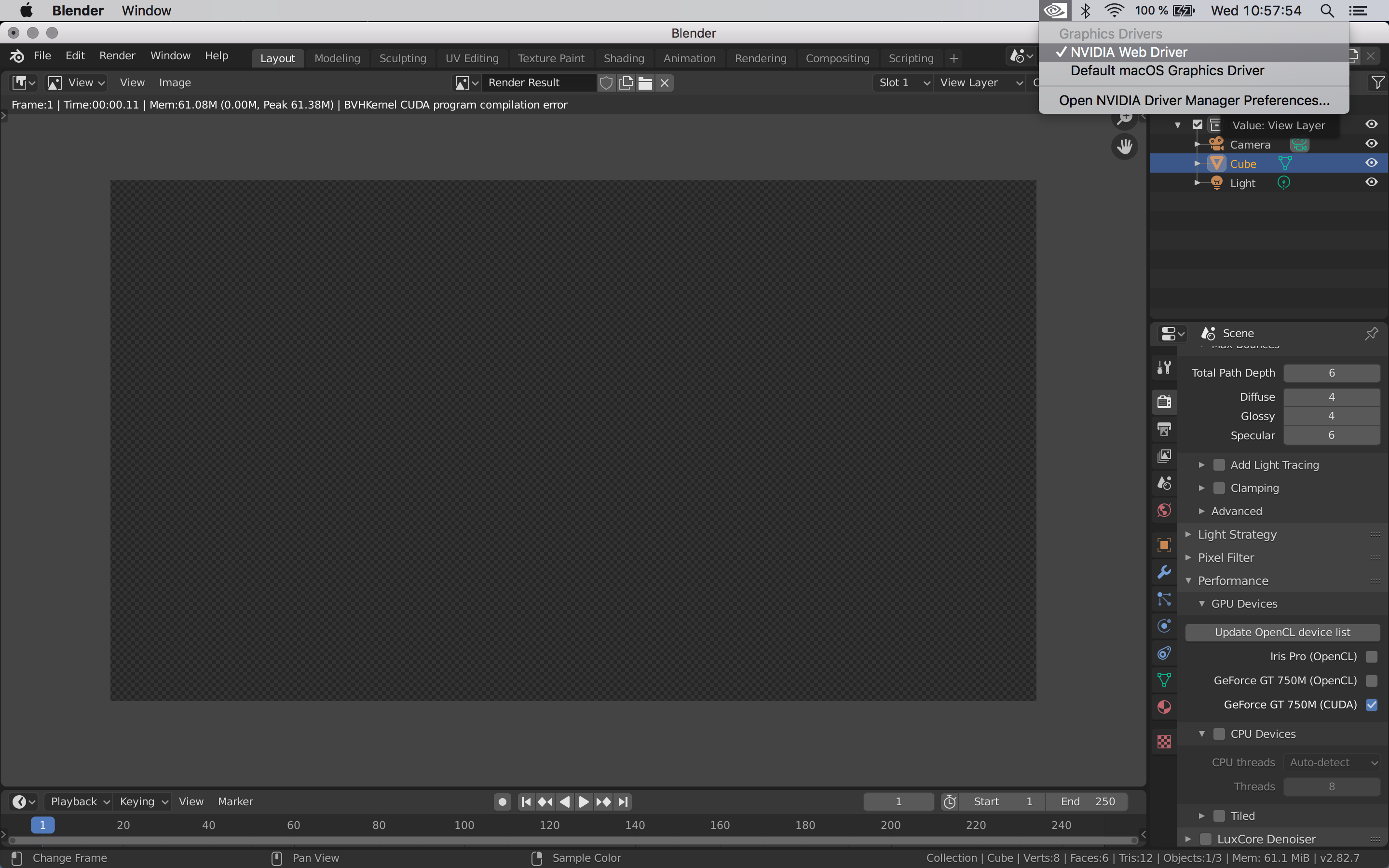

Instead I installed the driver & toolkit but not the samples, and so could make the add-on work.
But when trying to render with the cuda setting there is a BVH kernel compilation error.
I updated the cuda driver (418.163) via system preferences and apparently still the nVidia web-driver is in use?
Do I have to run some app from the newly installed CUDA developer stuff first to activate it?
libnvrtc.10.1.dylib exists in the bin folder.

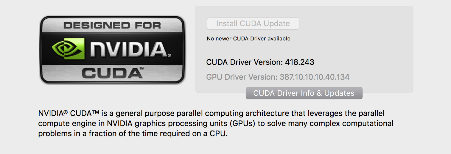

Can you run blender from terminal and post the output ?
This is the driver verision i run.
