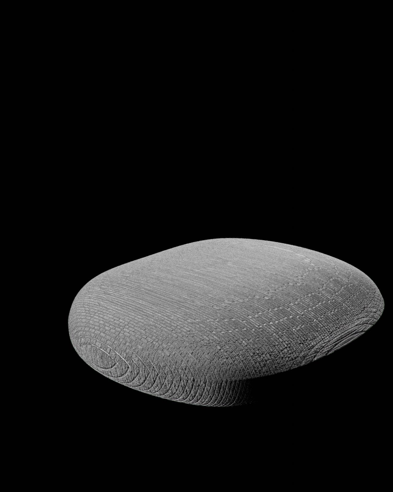

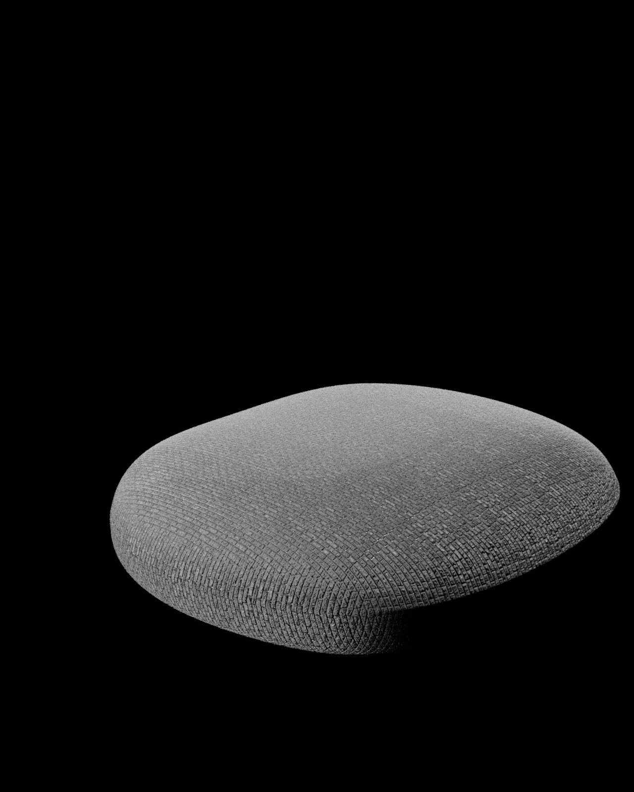

here's no uv on OCL:
and here on cpu:
notice that both objects show a faint seam on top but opencl version is also weirdly stretched (object is parented to empty and animated)

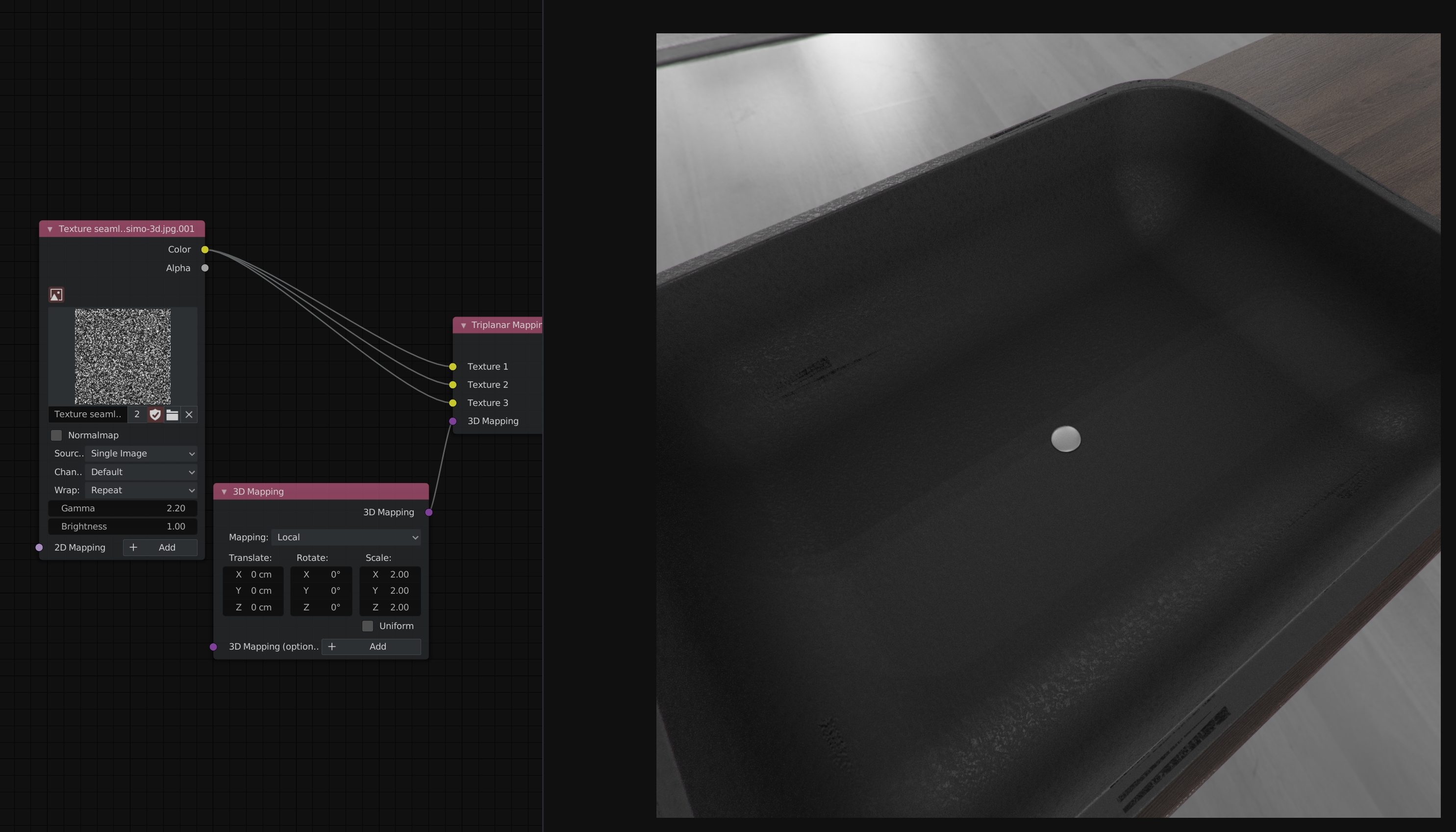

here's object with UV on opencl:
and here with uv and on cpu
having UV's fix the faint seam on both renders now but opencl still stretches the map weirdly. So right now only rendering on cpu while also having uvs work 100%.

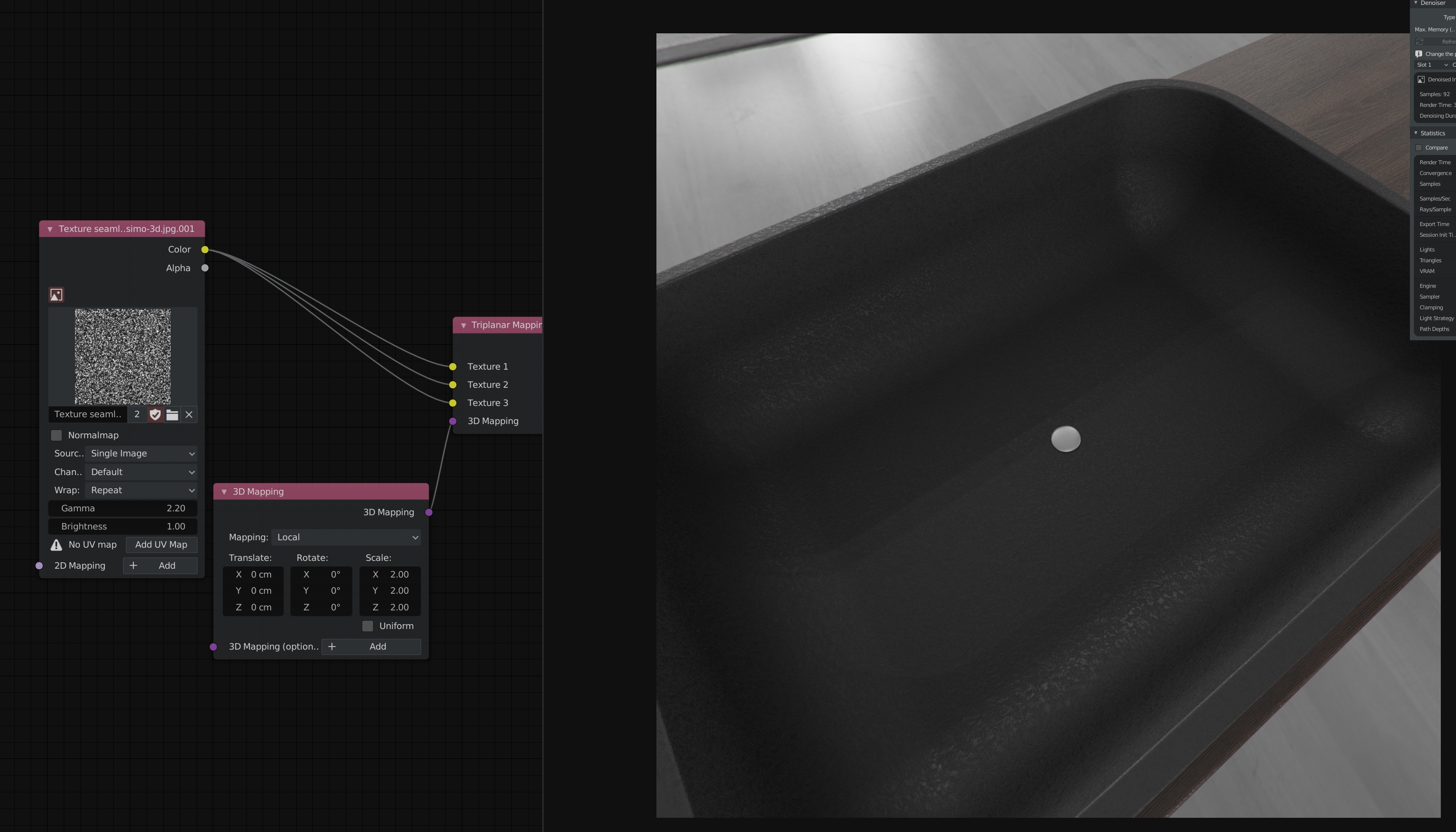

Aaand I even ran into an opposite problem.
object that has some uv(although bad one)
object has no uv(deleted uv's)
this is another pretty bad issue cause what If I want to use UV's for diffuse texture, but my roughness texture I want to have use triplanar.
How can I make sure my triplanar isn't affected by uv's or it's quality.
