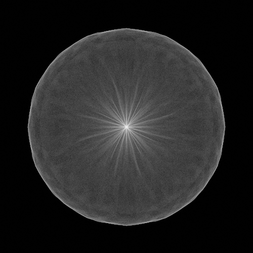

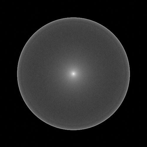

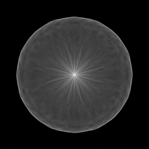

I did a quick test, and enabled the option for both custom split normals as well as autosmooth on a regular mesh. It is controlled by a second switch. The autosmooth version is enabled by default because v2.3 is the latest stable release.
I've also tested the difference on the rendering result. Using custom split normals does change the result a bit for the better. However, no change to the shift-issue. See the following comparsion with a single lens at the origin. First old mesh with autosmooth, second with split normals.
Then I also tested the influence of absolute size. Indeed, it seems that the "realistic" scaling leads to additional errors. A lens works better if it is a few m large. I find this strange, float should provide enough orders of magnitude to acommodate for everything, and it says everywhere I read that Blender internally uses float, just the display is rounded to 5 digits. Any ideas?

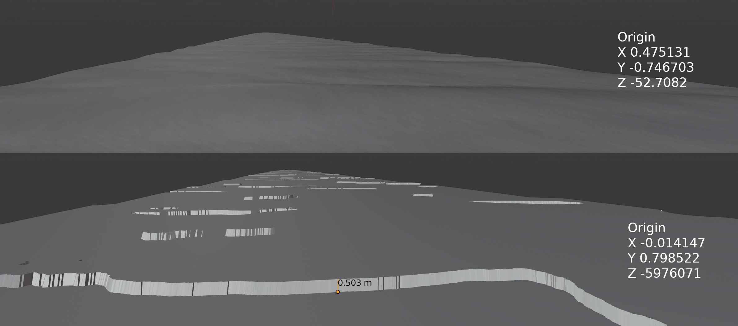

Blender precision is just horrible.
Here i only have small cut-off of earth real size, but i need real origin for procedural shader.
