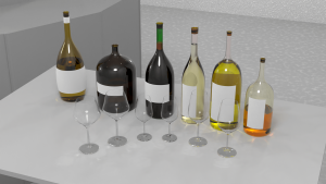

You clearly miss a correct lighting plus good reflection.just add a nice indoor Hdri it will look more realistic.

Ah, okay. Your suggestion would be very welcome if I‘d like to copy a real world scene at a photography. But actually I mean something differently with the word ,realistic‘. I fought with glasses appearing like a faint set of sun glasses. What looks definitely unrealistic for me for glass transparency if 1.0.
Maybe, I will try to produce a photography like rendering in near future.

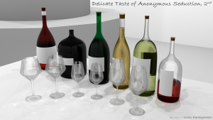

It reminds me very much of my early glass renders in POV-Ray. Check that you have enough light bounces (I recommend at least 32 or 64, probably even higher for a scene like this), check your surface normals are facing outward, and make sure you have something bright to reflect (like an HDRI that Sharlybg was suggesting). At the moment it looks like nothing is above 1.0 brightness, this is not realistic for reflections.
For an additional touch, you can experiment with internal volume absorption on the glass.

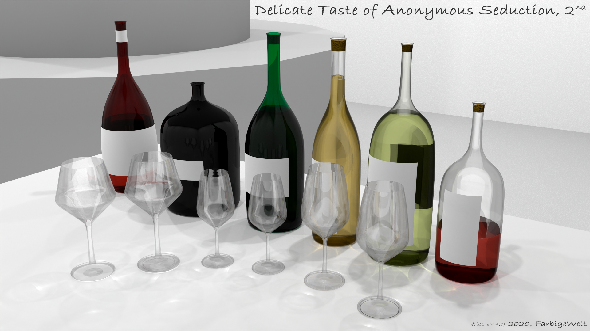

Thank you both for your ideas and suggestions.
I've placed the table with the glass ware in a closed, windowless room with 16 lights close below the ceiling each made from 3 separated triangle area lights (each 200 lumen). This lightening is pretty common realized with G10 LED spots.
How ever I tweaked the luxcorerender's glass the empty glasses have a grayish look I really do not like.
Any ideas of yours how to improve the glasses? Transparency, reflection, shadow color?
Delicate Taste of Anonymous Seduction, 2nd_indoor, 16x3 area lights_GPU Path, bounces 40, clamp 0.5, 14 kSamples, 2pc err_HD, 2h26m54s
MacBook Air with M1
Re: Mediabook
It looks like you might be using the glass material to color the liquids?
Use a clear volume with absorption color instead for physically correct absorption (the "colored glass" preset gives an example).
Judging from the shadows, it looks like you have way too many lights for a nice lighting. Try only two lights for a start.
It also seems like the wine glasses are either lacking thickness, or have an IOR close to 1? Make sure they have correct thickness and give them an IOR around 1.5.
Since the appearance of glass depends mostly on the environment around it, because it consists only of refraction and reflection, it also makes sense to improve the environment if the glass does not appear realistic. The easiest way is to use an HDRI of a room instead of a 3D-modelled room, but you can also improve the room 3D model (add a floor, light it realistically, place windows, doors, furniture etc.).

Use of an indoor HDRI is a very good input from all of you. Thank you.
In my opinion HDRIs are a fast and comfortable way to setup a simple closed room for a test scene with very good chances to get a photo realistic render of glasses and other materials. However, I am more curious about what is required to setup a scene with basic objects, lights and materials. I know this way a rendered image rather looks artificial, at least reasonable based on physics and almost everybody's experiences.

Internal Volume

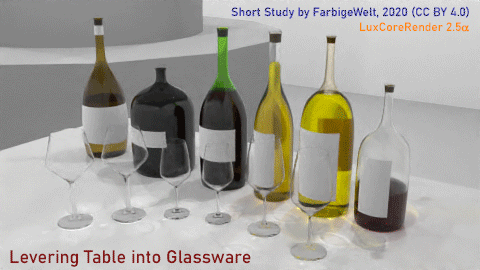

You are right! Internal volume's absorption color is the correct property of choice.
The objects are part of an older scene I've built in the first times of LuxCoreRender.
Meanwhile, I have to question the use of transparency color at all. At the moment I cannot think of any material absorbing parts of polychrome light's spectrum independent on passing through transparent objects path length, see e.g. Beer and Lambert.
Hard Nut to Shell
Looking closer at glassware and liquids design, locations, materials and volumes I had to notice different erroneous things set by younger me.

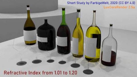

Refractive Index
One of those things younger me did correct.
However, I could not resist to illustrate effect of IOR glasses' look.
animated GIF, click to view
Bad Intersection
Depending on volumes' priority hierarchy one can observe rather strange effects if objects intersect unintended.
