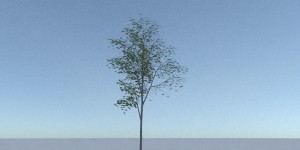

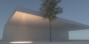

daros wrote: Tue Sep 28, 2021 11:16 am Hi Dade we followed your advice but still get this wen turning volumetrics on:
There is a problem when hitting the leaf back faces and "exiting" from something you never entered. I'm adding light source volume definition (like camera) to totally by pass the problem for BiDir (camera-only volume definition was enough for Path because paths go only in one direction).
I added the support for light source volume definition (pretty much useful only for BiDir).
You can now set the camera volume:
scene.camera.volume = "envVolume"
And light source volumes:
scene.lights.84678.volume = "envVolume"
scene.lights.84678_sky1.volume = "envVolume"
and the rendering will work without having to set all materials volumes (indeed with the exception of "fog" box):

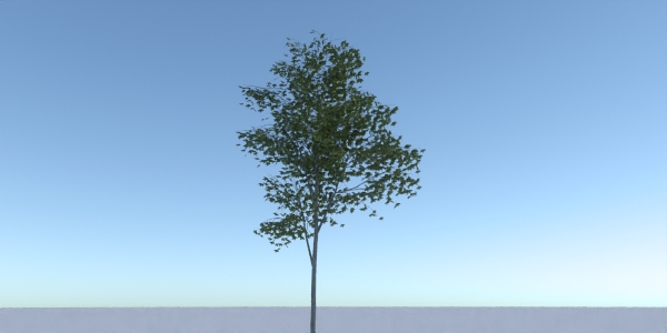

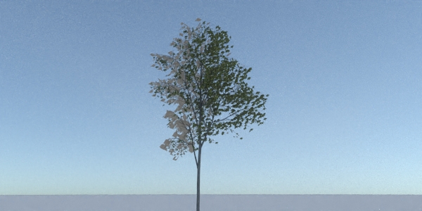

Hi Dade, now we have two other problems.
1) After you update and following your instructions we got a few other wired results for theleaves.
no volumetrics:
with volumetrics (no internal/exteranl volume definition on the leaves)
with volumetrics (with internal/exteranl volume definition on the leaves)

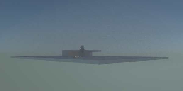

2) I get the volumetrics of light emitting materials only if i define internal/external volume for everything.
If i do not assign any internal/exteranal volume to everything volumetrics of light emitting surfaces do not show up.
So in order to have volumetrics of lights we ketpt internal/external assigned to everything.
Is that correct?

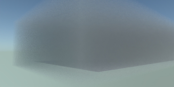

But i get the cloud wen the camera is outside, which is cool!

Re: Volumetrics issues
Hi Dade, we did but as i wrote in this case the backfaced leaves disappear completely and i do not get any volumetrics form lights.
Here is the file with material volumes off:
https://drive.google.com/file/d/1NXbxk- ... sp=sharing
