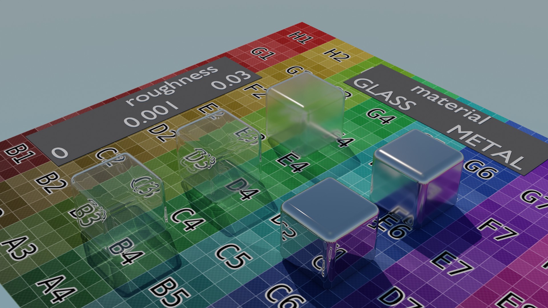

Martini wrote: Mon Aug 23, 2021 4:22 pm From what I can guess/observe by looking at the render result, it looks like the transmission is not present in the rough glass, and perhaps the normals are a bit weird also.
Looks like roughglass is working spectacularly well in latest build (sorry for not testing for a few days) :D
LuxCore roughglass
LuxCore roughglass
Thanks Dade

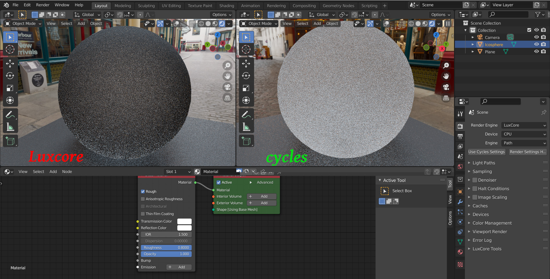

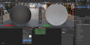

On my side wit lasest blendluxcore build the darkening issue is still there :
rough_glass.blend
(988.33 KiB) Downloaded 413 times
I don't how it is possible to solve it without a multiscatter glass model.Cycles solve it this way of course. the non scattering version aka ggx give same dark result as lux. And you have to put it in multi scattering ggx for this to work.
Posts: 822
Re: Two well known luxcore problems.
Naive thought here...
Would it be possible to get a trick like "NO Energy loss" (no lightloss, no falloff or best - customizable control for light falloff) or switch to affect specular & glossy materials, so in principal, a user could create rough glass as bright as Env. light?

kintuX wrote: Sun Sep 05, 2021 8:38 pm Would it be possible to get a trick like "NO Energy loss"
Agreed, in Cycles you can configure a glass material (using "ray depth" node or sth.) that does not return black after the last bounce but instead switches to transparent and thus guarantees bright glass appearance.
If this could be somehow coded into Lux glass shader maybe the problem were solved?
Why go this way if a more accurate less tricky way exist (multi scattering rough glass) ?
