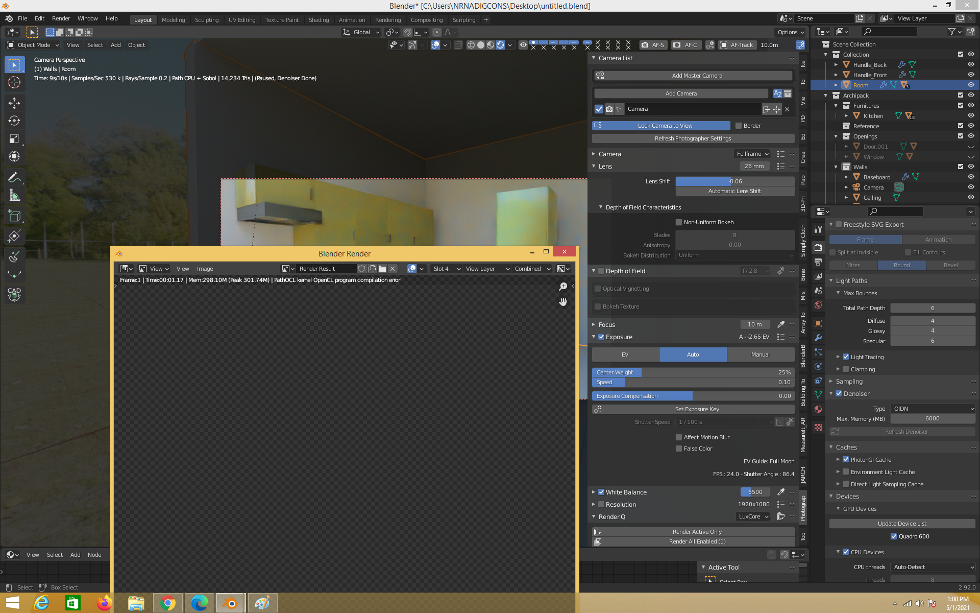

Hello team,
i have query , i not able to render using GUP(NVIDIA Q600). THE FOLLOWING ERROR IS DISPLAYING.
pathocl kernel opencl program compilation error.
REGARDS
NRYBN

nrnadig wrote: Sat May 01, 2021 7:39 am i have query , i not able to render using GUP(NVIDIA Q600). THE FOLLOWING ERROR IS DISPLAYING.
The NVIDIA Q600 is a Fermi GPU, it is very old: I think it was released about 10 years ago. The driver doesn't support a CUDA version recent enough to be able to run LuxCoreRender.
I'm afraid you can run only CPU rendering and you can not use the GPU.
