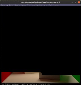

I'm working on this topic. Random/Sobol samplers will have 2 different modes: a progressive one (like now) and a tiled cache-friendly one (to use mostly with out-of-core rendering but not only):
