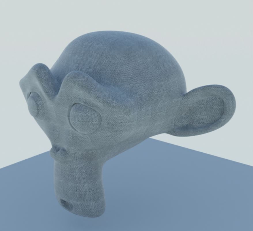

Agree, with normalmap it should not work, I mean, is like if you get a normal map for an object and you change it's orientation rotating the texture, it will be wrong, this is kind of the same :)
BTW this is a quick test of sheen and triplanar, bump included, it awesome :)
