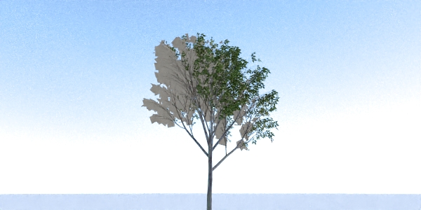

Hi Dade we followed your advice but still get this wen turning volumetrics on:

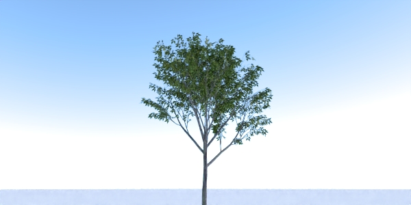

volumetrics off

daros wrote: Tue Sep 28, 2021 11:16 am Hi Dade we followed your advice but still get this wen turning volumetrics on:
There is a problem when hitting the leaf back faces and "exiting" from something you never entered. I'm adding light source volume definition (like camera) to totally by pass the problem for BiDir (camera-only volume definition was enough for Path because paths go only in one direction).
