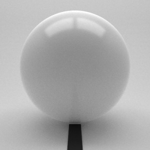

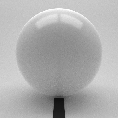

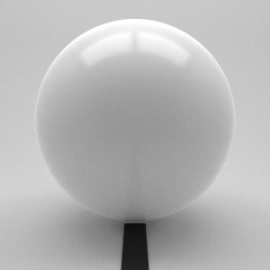

I should have fixed the problem, this is a rendering with old code:

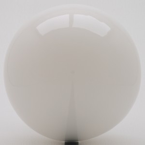

and with the new code:
Note how the fix doesn't affect only the edge but the overall look of the material.

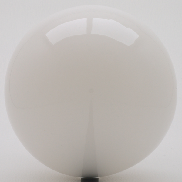

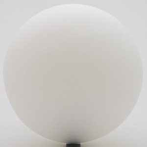

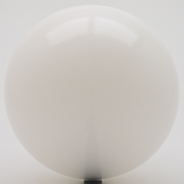

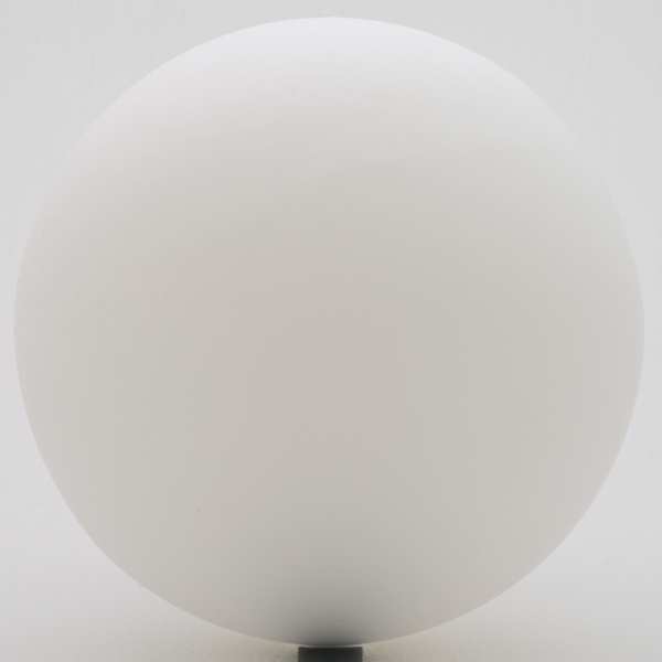

I don't know if this helps.
Those are real world samples of exactly the same set-up
Lime only, spehere and box.
Lime only+transparent lacquer, spehere only
enameled cermic, spehere only
Tone mapping of the photos is linear, no highlight compression, almost pure RAW, only white blance, camera Sony Alpha 7 III with 50mm Zeiss lenses.

Could you share the lighting setup (diagram & full specs, if possible)? Unless you already recreated it digitally (1:1), then scene file would be most welcome... ;) appreciated!
PS
Also, did you took those with macbeth colorchart for color correctness? I wonder cuz of warm tone...

It's the same scene which has been shared by Sharlybg on page 3.
Fstop 22, shutter 1/10, iso 100, focus at the front of the sphere, camera position in the center of the hole of the backwall
White balance is the same for all materials we sampled, so some show up warmer and others colder.
