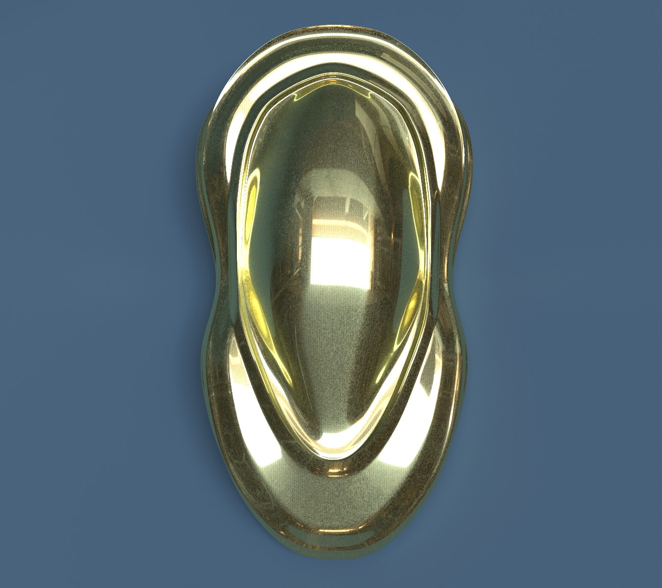

Is it correct to totally disregard SHADING NORMAL pass & denoises anyway?
Eg.
Gold w Bump (Normal map), rendered to 5k samples (Halt Noise Treshold @ 6).

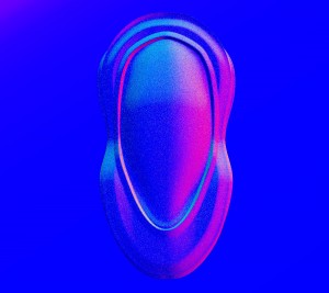

kintuX wrote: Wed Jun 23, 2021 10:50 am Is it correct to totally disregard SHADING NORMAL pass & denoises anyway?
OIDN uses the Avg. Shading Normal pass (Avg. = Average).
In the Blender addon, it is enabled automatically behind the scenes when the denoiser is used.
Posts: 822
Re: New OIDN 1.4 with new features and better detail preservation
B.Y.O.B. wrote: Wed Jun 23, 2021 11:32 am
Oh, so that's why details are gone. (Yes, avg. nrml pass was smooth)
Is there a simple way to switch it?

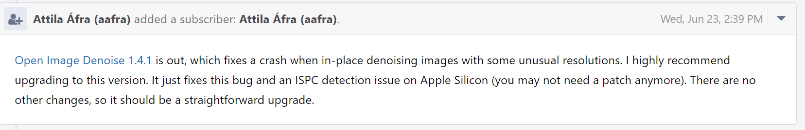

One important thing regarding OIDN 1.4.1:
