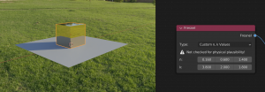

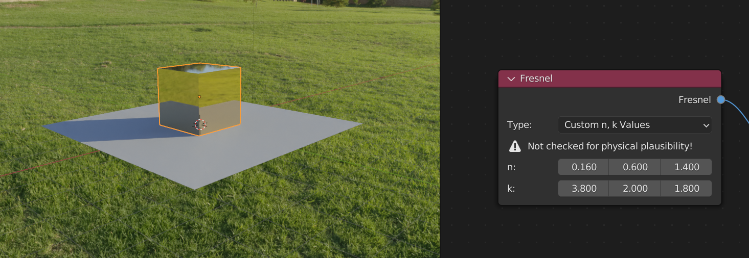

I went back to check, and actually it was already so that you had the option of RGB inpout for n and k in LuxCore as well.
However, it is configured with a value limit in the range of 0 to 1, while for metals values up to 10 are typical.
With two lines of code changed this can be improved:
I will try to also make the default window size wider, by default you don't see the decimal digits, then I would commit the change. (Edit: commited)

Yes, this is it! And works as expected.
My guess is, it's how it was intended from start, since everything was already in place. :)
TYVM for great work & co-op. 8-)
