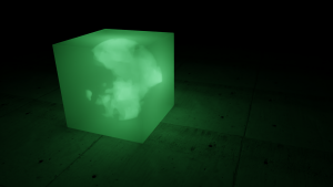

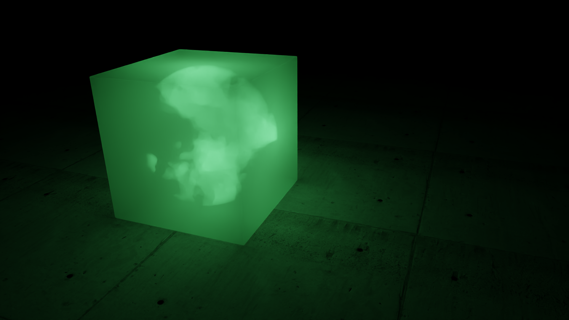

DionXein
Posts: 81
Re: Sub-Surface Scattering
Post by DionXein »
MetinSeven wrote: Wed Nov 04, 2020 3:28 pm Isn't there a scientifically viable way to retain light strength inside a volume in a more effective, but still physically correct way, like some real-life plastics seem to almost emit light due to SSS?
You can try to lightin some parts inside mesh, using emission socket.
Posts: 527
For now, that would loop back to Dade's earlier tip: add some emission to emulate the behaviour. Depending on the absoprtion depth, I could imagine you wil be better off with emission on the surface material rather than the volume though...
Edit: I worte this at the same time as DionXein, so just to clarify: Not a contradiction to what he shows, just a guess for different scenarios.
