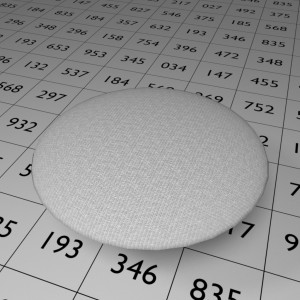

lacilaci wrote: Mon Jan 06, 2020 12:38 pm Another issue with this, related to opencl
opencl
cpu
I fixed a problem in OpenCL code and now the output is the same. Can you check if this has solved the "seams" problem too, it working fine here:
