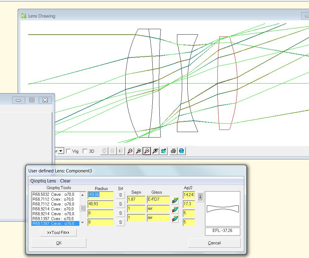

@CodeHD
1. Didn't you thought about adding feature of exporting preset?
2. There's lens which have different radii (I mean aperture) on its front and back sides, like the one at the middle on picture. There's no support for this in plugin, right?

Made another tessar. Now I think I have some difficulty. All lenses in winlens library are 100 mm focal length. I want 35 mm.

About the 100mm vs 35mm issue, that's not easy to solve unfortunately. You would need to find a 35-mm design somewhere else. Maybe there are other lens libraries around?

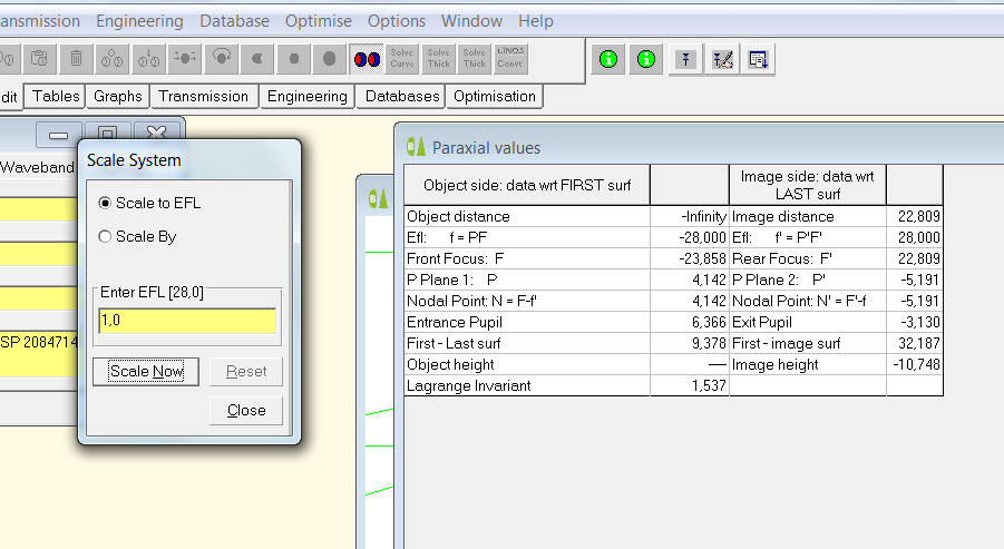

After attempt to recreate lens from image from the internet and inventing working! but not focusing on infinity lens system, I've discovered this:
Ther's button in edit tab which look like pair of red/blue eyes.
Just enter desired efl and get your new lens!

Anyway, here's downscaled 100 mm lens. I wanted it to be 28 mm, but it end up being not full-frame, so I think it's equivalent focal length is around 32 mm. I think it's nice anyway and it has sharp focus.
