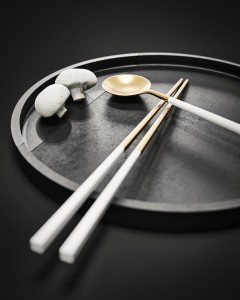

Aaaand a silly image...

Post by Racleborg »
looks really goodl! :)
Posts: 818
Re: Laci's wip
Post by epilectrolytics »
Yes, great composition, simple but effective.
Mushrooms need some SSS though.

Post by lacilaci »
epilectrolytics wrote: Fri Jan 03, 2020 8:10 am Yes, great composition, simple but effective.
they have some, but i found it hard to control so I left it very weak. I'm still hoping for some fast sss options on upgraded disney shader for most objects that need sss. Hell, in cycles you can even make a really good loking skin with that stuff.
anyways, this was just a random render. I'll post full kitchen on final works "soon"
