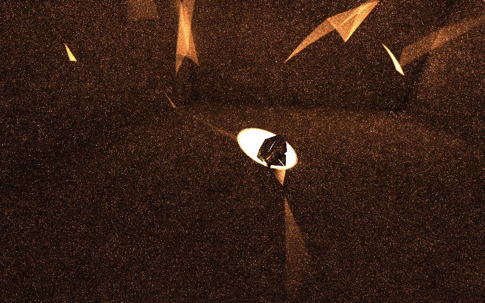

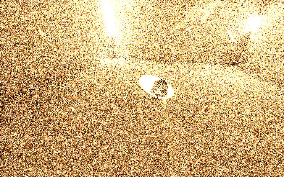

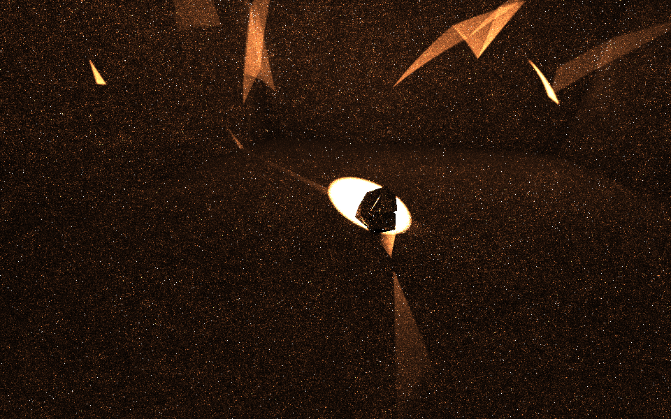

Hi Guys,
now I have simplified the problem. I have a scene (find in attachments) that I start using Luxcore UI. I start it 3 times and I get 3 different results. So the seed is constant, camera position is constant. I thought that the PhotonGI cache should resolve flickering issues but it looks that it makes flickering even stronger:
https://limewire.com/d/RmjLd#eqhZSE1yex
I do not add pgi file as it is heavy, and luxcore will create it after first render, but if it could be helpful for anyone just let me know.

Hi bartek_zgo
Your renders look to me as if Camera>Tonemapper applied somehow with different settings.

Thanks for the test scene. I can reproduce it in LuxCoreUI
- First time opening, it starts by computing Caustics Cache I get your first image as the result. A .pgi is created
- Second rendering, it starts immediately. I get your thrird image at the start. Seems like LuxcoreUI later crashed, maybe I accidentally closed I don't know
- Third rendering, the cache is loaded, Image 1 again by the looks of it
- Fourth rendering same as before, your image 1
I then deleted the files and re-extracted your zip file to delete the .pgi and make sure to undo anything implicitly changed, jsut to be sure.
- First time the cache is computed. I get your image 2
- Second time, I get your image 1
- Third time, I get your image 1
So, we have a test scene, and the issue can be reproduced. That is good!
I will put it into a GitHub Issue.

FarbigeWelt wrote: Fri Jun 06, 2025 12:32 pm Your renders look to me as if Camera>Tonemapper applied somehow with different settings.
I will take this into account in the bug report.
The fact that my two attempts leading to different results during the first try (where the cache is computed, not loaded), would suggest that it indeed may not be the cache loading after all.
