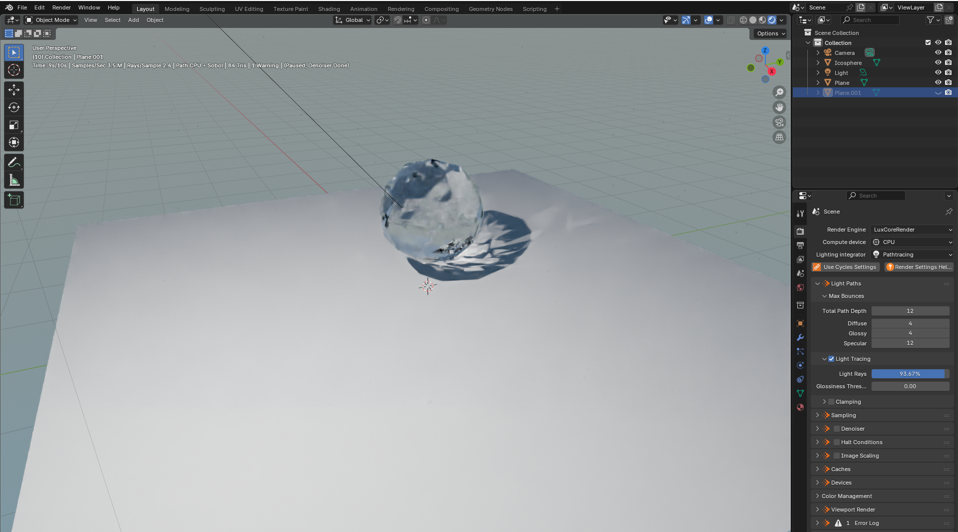

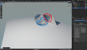

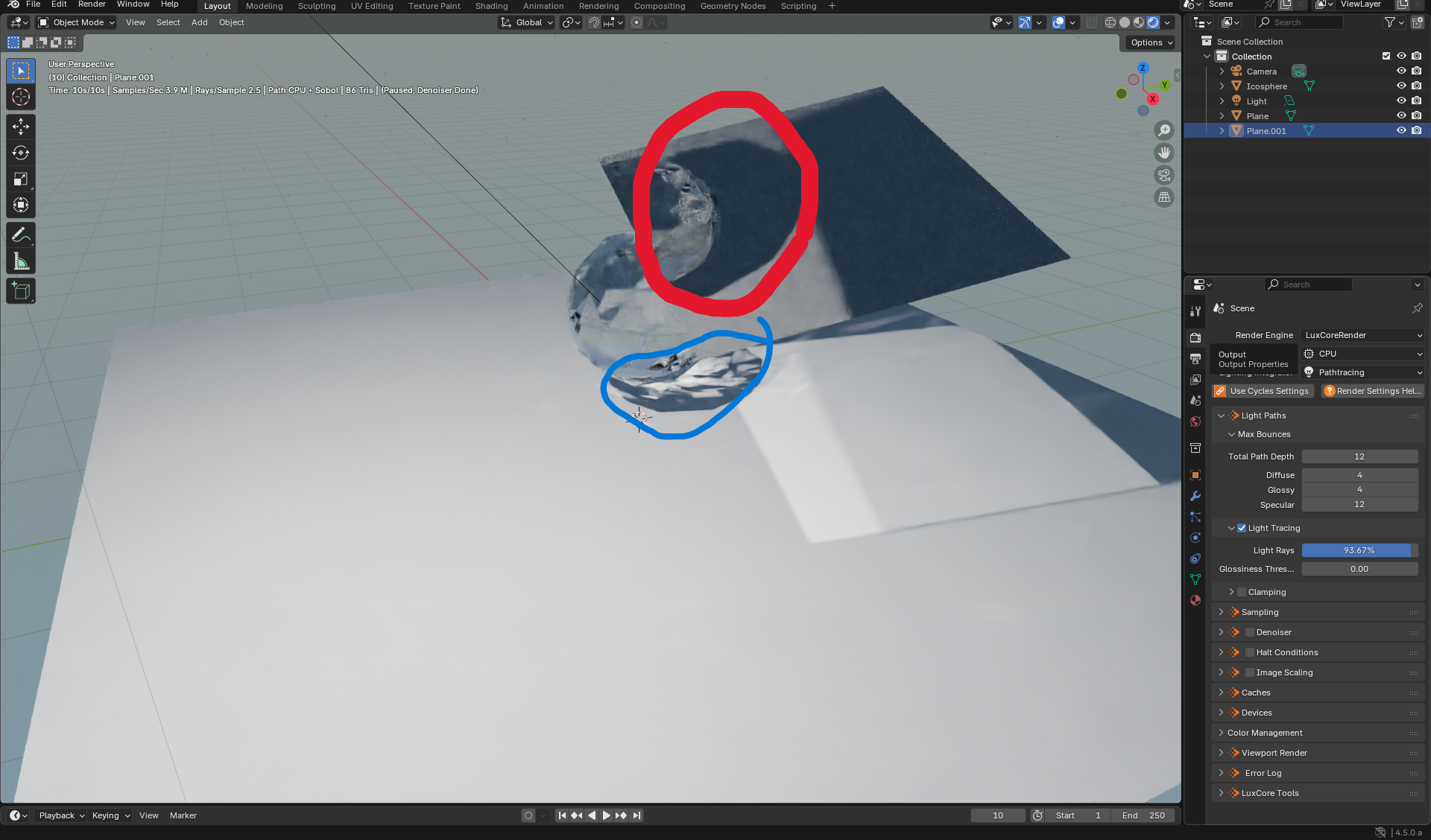

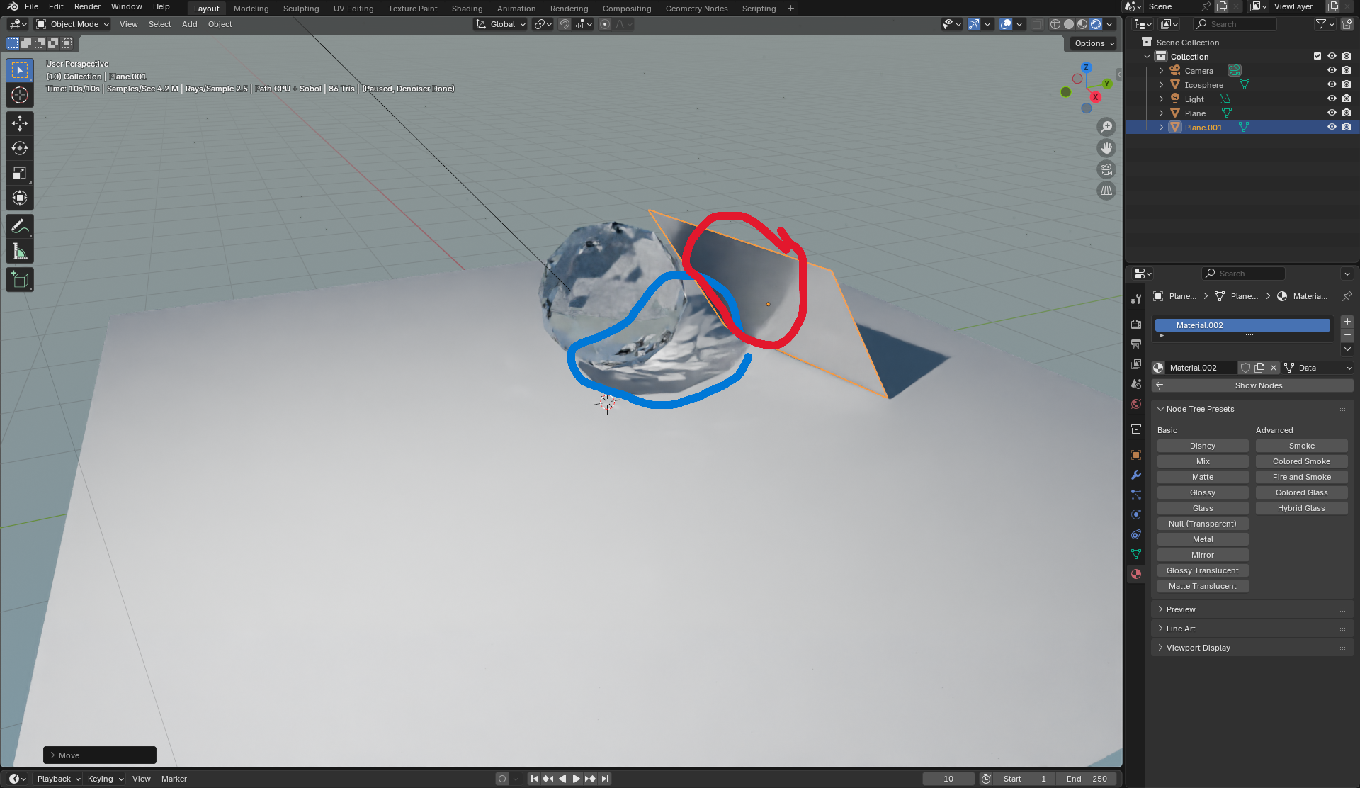

The other thing that i am missing is caustics that would see trough transparent objects (same with reflections - so refraction and reflections doesn't support light tracing - in blender it works) - maybe intel's path guiding technique would be one solution because blender is using that one and it works.
I mean this: see the images (the other one has glass feature on both objects / refraction: no caustics.. and the other screenshot has two objects where other one has glass shader and other one has metal shader and there is no caustics on reflection). Damn I am bad explaining things, i hope screenshots are clear enough to explain "problem"

Juhis wrote: Wed May 07, 2025 8:28 am The other thing that i am missing is caustics that would see trough transparent objects (same with reflections - so refraction and reflections doesn't support light tracing - in blender it works) - maybe intel's path guiding technique would be one solution because blender is using that one and it works.
FYI: Path guiding was already on the list, deformation motion blur has now been added.
About the issue you describe: This is the good-old topic of "SDS" paths.
For the specific scene you are showing, LuxCore already has the "CausticsCache" that can deal with this.
Of course this may not be sufficient for certain more complex scenes, but how much Path guiding will solve remains to be seen, I will say.
There is also the BiDirVM engine that s not exposed in BlendLuxCore. It may also be suitable for some cases. Further testing required.

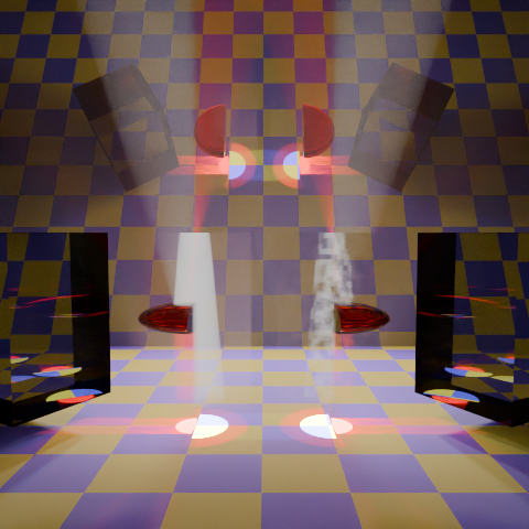

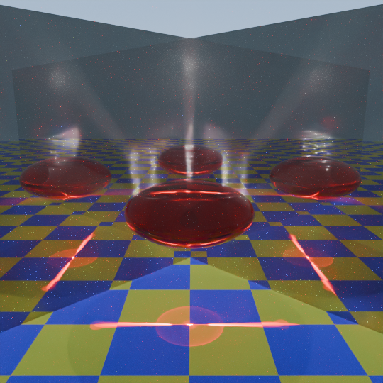

I encounter strange Volume effects I may post more details next week things like Laser scattering is not visible with path tracing but with BiDir. Also scattering seems to leave volumes if reflected inside a scattering volume.
Path tracing
Path tracing
BiDir
BiDir
Posts: 1083
Re: Call for Ideas - Volumes Homo, Hetero
Post by FarbigeWelt »

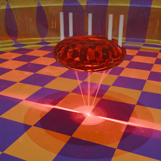

In Lenses Reflected Area Lights scattering in Clear Volume
BiDir Scatteringin Clear Volume

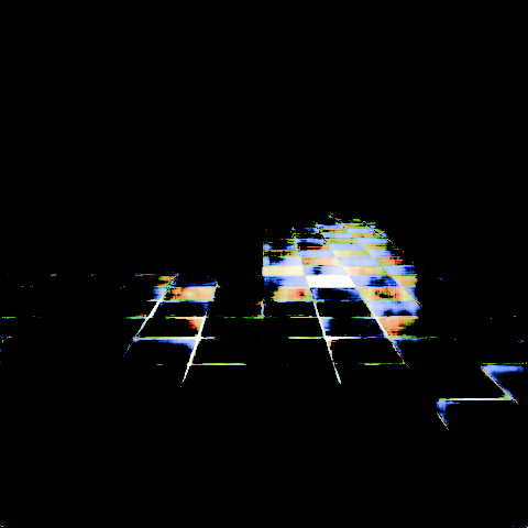

Path tracing missing indirect lights and scattering in Homo and Hetero Volume

FarbigeWelt wrote: Sun May 25, 2025 9:28 am I encounter strange Volume effects...
Please note that we are aware of some volumetric issues to be addressed in version 2.11, for example see this:
https://github.com/LuxCoreRender/LuxCore/issues/647
