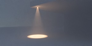

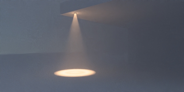

wow... it seems to work. Sorry, it was difficult for me to understand the logics behind that.
Thanks again dade.

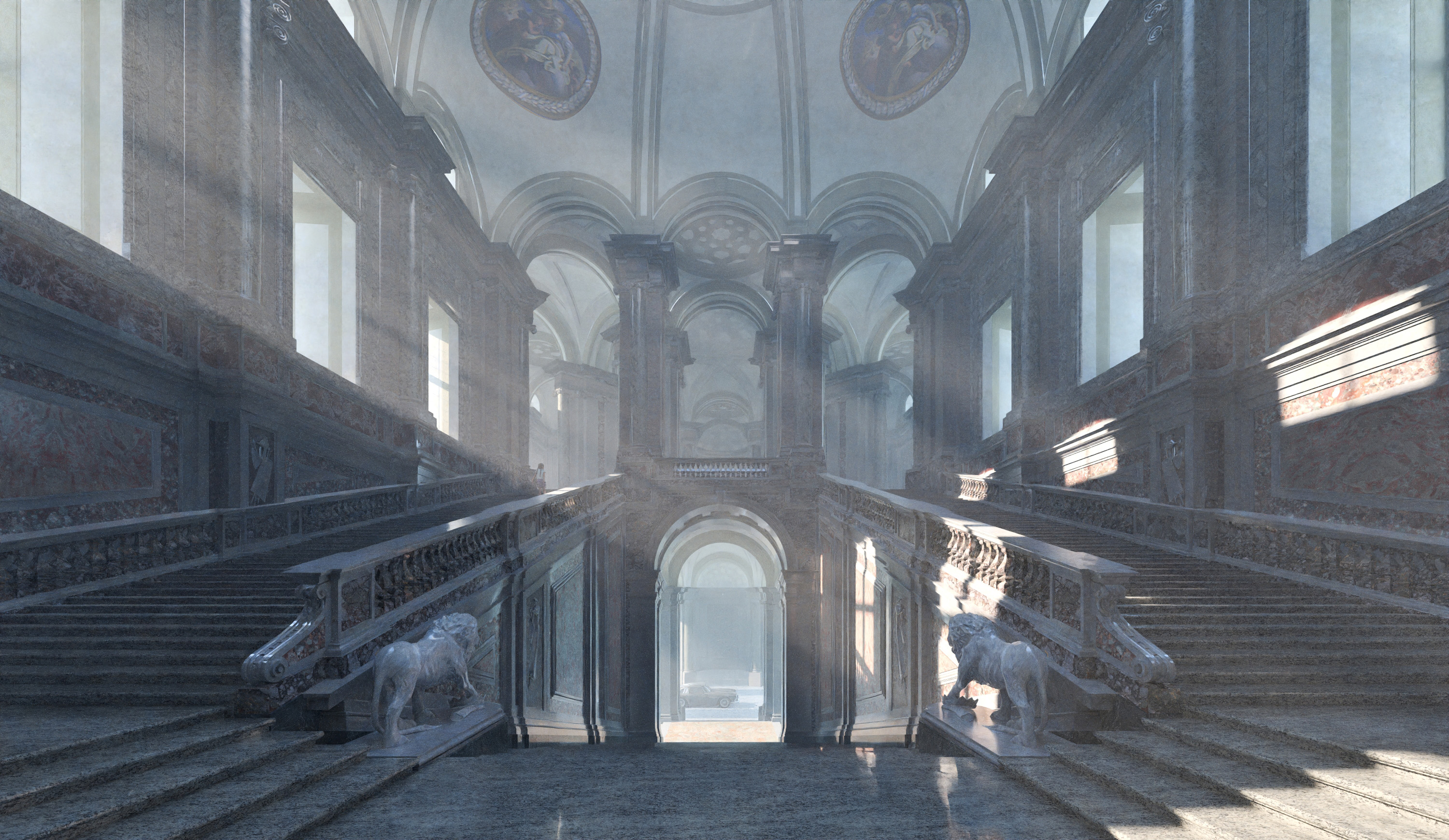

i love it!!!

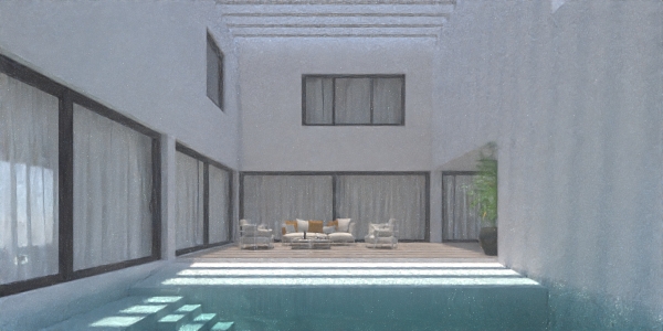

Hi, new issue:
This is what i get from this scene with volumetrics turned off:
and this is what i get wen i turn volumetrics on, water has gone:
it's a volume priority issue?
if we have the fog volume surrounding the scene set as interior volume, the walls as exterior volume, and the water as interior volume, which are the priorities which we have to assign to each volume?
We tried with fog volume set as priority 0, the walls as priority 0, and the water as 1 but the result is the same...

Posts: 821
Re: Volumetrics issues
Naturally, solids have higher priority than fluids, which have higher priority than gases.

Posts: 472
Post by acasta69 »
daros wrote: Thu Sep 23, 2021 8:21 am We tried with fog volume set as priority 0, the walls as priority 0, and the water as 1 but the result is the same...
It seems that all volumes in your scene are defined with the same ior = 1.5, so no difference between fog and water...
scene.volumes.envVolume.ior = "1.5"
Posts: 309
Thanks acasta69, sorry for the stupid error.

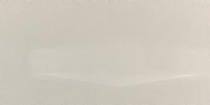

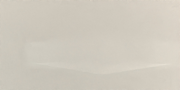

now a new question.
the following picture is taken with the camera outside from the fog box.
Why i do not see the blue sky which is set as environnment around the fog box?
Thanks again for your help.
cameraOutOfBBox.zip
(9.17 KiB) Downloaded 885 times

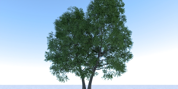

Posts: 309
and one more question but i cannot upload the file today.

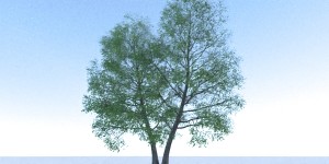

here is a tree with fog off:
and here we have a very thin fog, about 10km visibility
why the shading of the tree shows up so differently?
tomorrow morning i can upload the luxcore scene.
air now is set to ior 1
