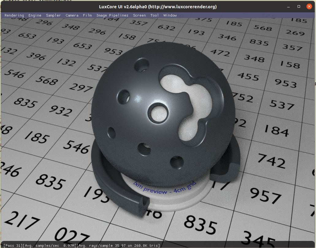

This is a rendering with intentionally bad RR settings (0.97M samples/sec):

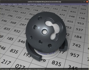

This is a rendering with default RR settings (3.41M samples/sec):

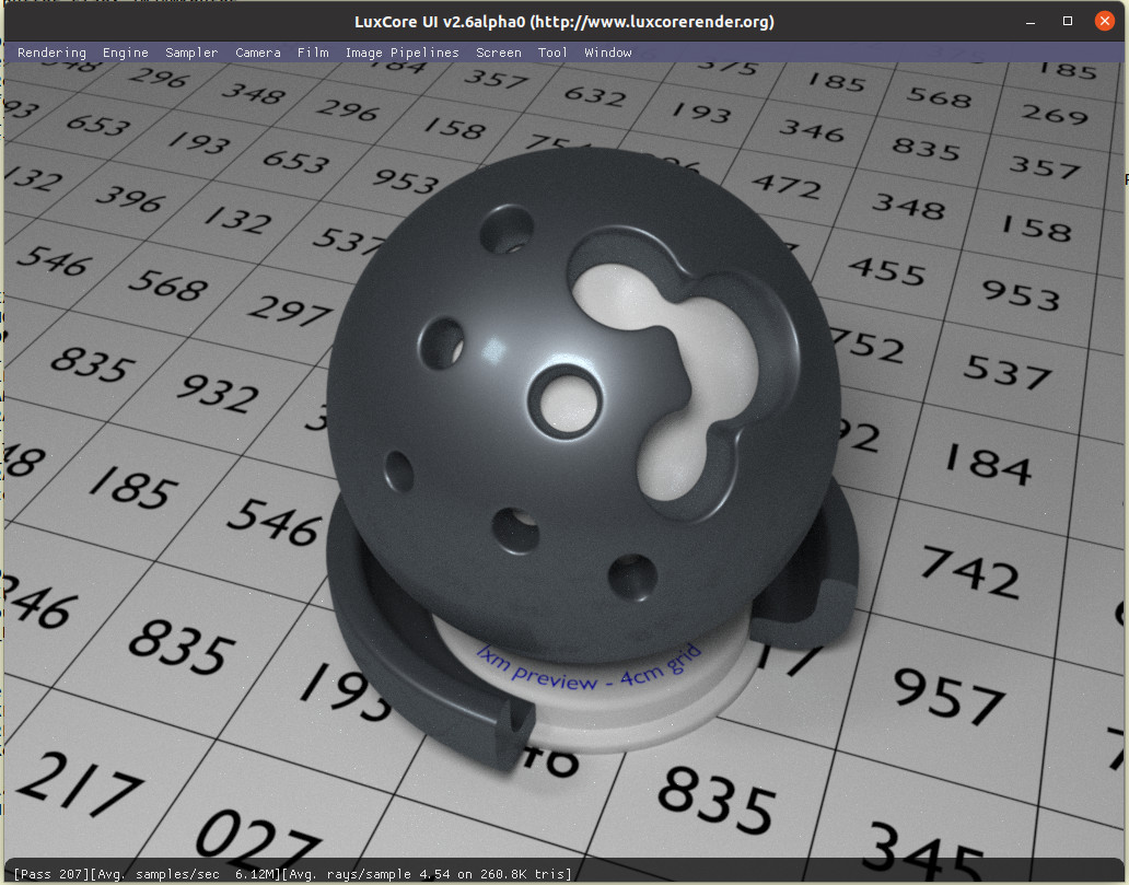

This is a rendering with intentionally fast RR settings (6.12M samples/sec):
As you see I can manipolate the samples/sec however I want. But check the "rays per samples": the first one traces ~36 rays per samples while the last one only ~4 per samples. Clearly the last one is perceived 6 time "faster" ... but it isn't, it has just more noise and potentially fireflies.
The 3 renderings are still unbiased so they converge at the same solution on the long run.
In the case of Cycles and its clone, I assume by looking at the rendering, they are instead biasing more or less the rendering, cutting stuff. In particular, it is quite evident like E-Cycles does, most of the times, direct light only renderings.
