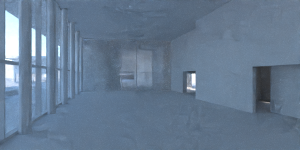

This one is with prefiltering off...
no big difference regarding the transparencies

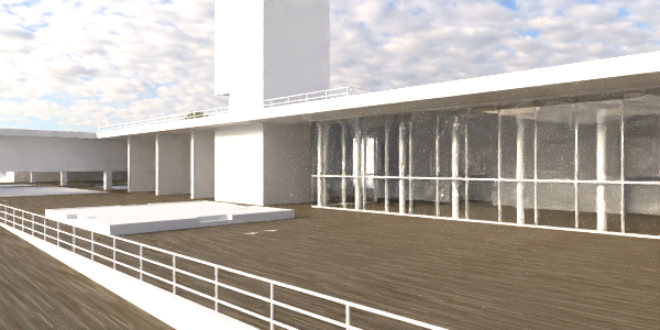

daros wrote: Wed Jul 07, 2021 11:27 am latest oidn
unfortunately even the areas where oidn gets lost are very visible.
The only solution I see, for this kind of problems, is to increase the samples per pixel and/or increase the rendering resolution and than scale down the result. It is easy to test, if you render at 64/128/256 samples per pixel and increase the resolution 600/1200/2400 pixels, the problem fades away.
This is a problem somewhat specific of BiDir and having to disable pixel filtering because of OIDN (Path tracing uses a different kind of pixel filtering).
I'm playing with the idea of having a very special pre-processing of Albedo and Normal AOVs for BiDir: they can be computed very very fast by a dedicated rendering step instead of having them as side product of BiDir rendering.
The problem is BiDir has a very very low samples/sec speed and this affect the quality of Albedo and Normal AOVs. If I render them in a dedicated step with a lot more samples it should improve the quality of the denoise output with a very little cost.

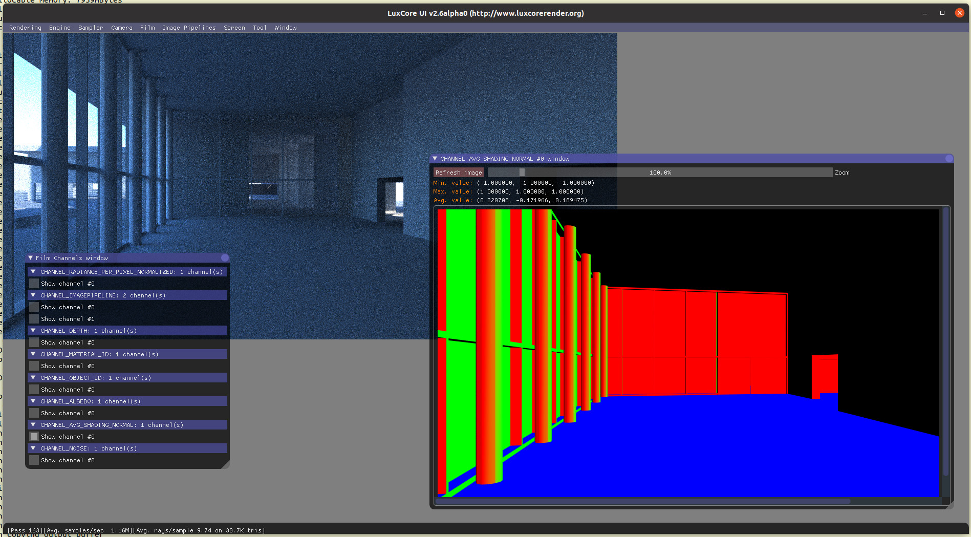

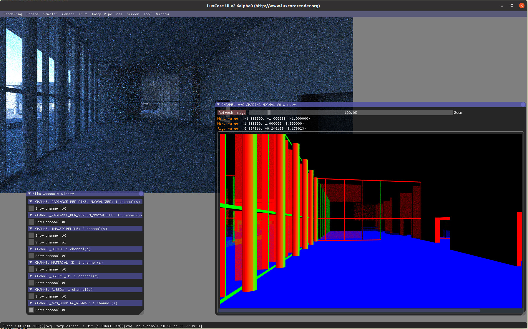

I think I can fix this problem:
See the normal AOV ? It uses the normal of the glass instead of the normal of the surfaces seen trough the glass (so it is not aligned with the Albedo AOV).
I need to have for normal AOV the same setting I have for Albedo AOV.

Re: New Albedo settings and more Denoiser related changes
Now the Normal AOV is consistent with Albedo AOV settings (compare with my previous post):
I have also added the pre-filtering of normal pass because it can now noise as albedo.
I will now check if I can get something out of the idea of a pre-rendering of Albedo and Normal AOVs.

Dade wrote: Sat Jul 10, 2021 11:20 am Now the Normal AOV is consistent with Albedo AOV settings (compare with my previous post):
I'm sure I'm not reading this correctly, but is this part of the normals correct? Looks a bit strange to me. :?
Martini wrote: Sat Jul 10, 2021 12:28 pm I'm sure I'm not reading this correctly, but is this part of the normals correct? Looks a bit strange to me. :?
Yes, it is the reflection of the side (glass both reflect and transmit and Albedo and Normal AOVs show that).

Dade wrote: Sat Jul 10, 2021 12:59 pm
Ah of course. Thanks for clarifying :mrgreen:

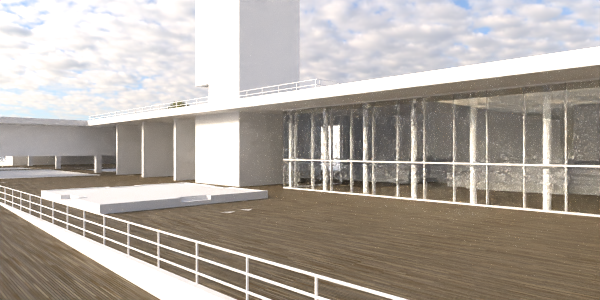

Today I have updated our luxcore to latest commit. Unfortunately I do not see any improvement with denoiser.
With high quality it looks the same. The same problems with carpet.
Old (updated on 7'th Jully):
New (updated today):
With low quality glass looks even worse.
Old
New
