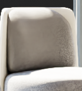

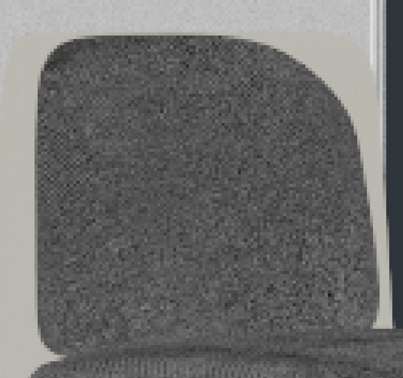

This is one situation where I think having the option to consider the albedo as totally clean and not prefilter it could be better, in this case we loose detail in the cloth texture because it's being interpreted as noise when it's not, and the scene has more than 3000 samples.
This is the denoiser output:
And this is the Albedo:
I can assure you that the Albedo is totally clean, but OIDN is considering that detail as noise I suspect, and that's why it's removing it from the final image.
So having this option I think can improve result in these situations, and I imagine that's what the option is useful for.

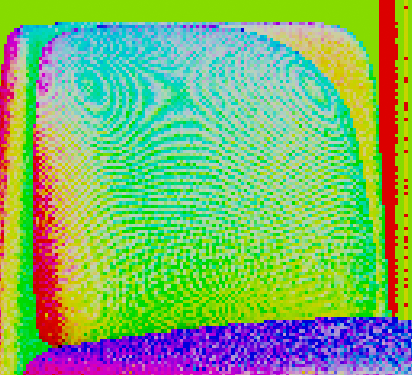

I can easily add an option to enable/disable albedo pre-filtering but how does look the normal pass in that case ?

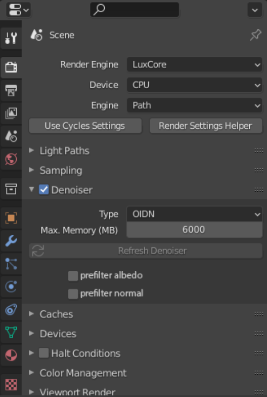

does that also mean you can turn it off and on for albedo and normal individually. i would think something like this in the blender addon
(this is just photoshop)

Is maybe lack of microfacet normal mapping having a diminishing affect on denoiser?
Re: New OIDN 1.4 with new features and better detail preservation
kintuX wrote: Wed Jun 16, 2021 10:07 pm Is maybe lack of microfacet normal mapping having a diminishing affect on denoiser?
That is the reason of my question.

bestman8 wrote: Wed Jun 16, 2021 9:45 pm does that also mean you can turn it off and on for albedo and normal individually. i would think something like this in the blender addon
Normal doesn't/can't be filter but yes for Albedo.

I don’t have the render right now, I’ll repeat it tomorrow and show you the normal, however it was pretty clean, the shader is mainly Albedo and roughness, with a tiny bit of normal, the artifacts you see there are because a too high normal intensity, but the blurring happens without that too (I tested it 10 minutes ago, before seeing this message, sorry)

Here is an example with the three channels, Beauty, Albedo and Avg Shding Normal.
As you can see all the texture detail is being killed in the denoise process, and I think it is because the Albedo PreProcess detecs the texture detail as noise.
Albedo is noise free enough, at least to try it, you see it here a bit pixelated because it's a zoom, and the texture has a very fine grain detail, so the "noise" you see is part of the texture, not part of the render.
Beauty with noise blurrying the result:
Albedo noise free
Normal

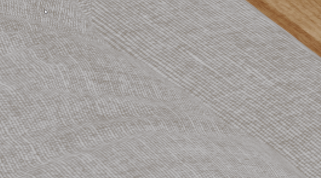

Also here is the crop oat real resolution.
Denoised:
Captura de pantalla de 2021-06-23 00-02-24.png (77.23 KiB) Viewed 22913 times

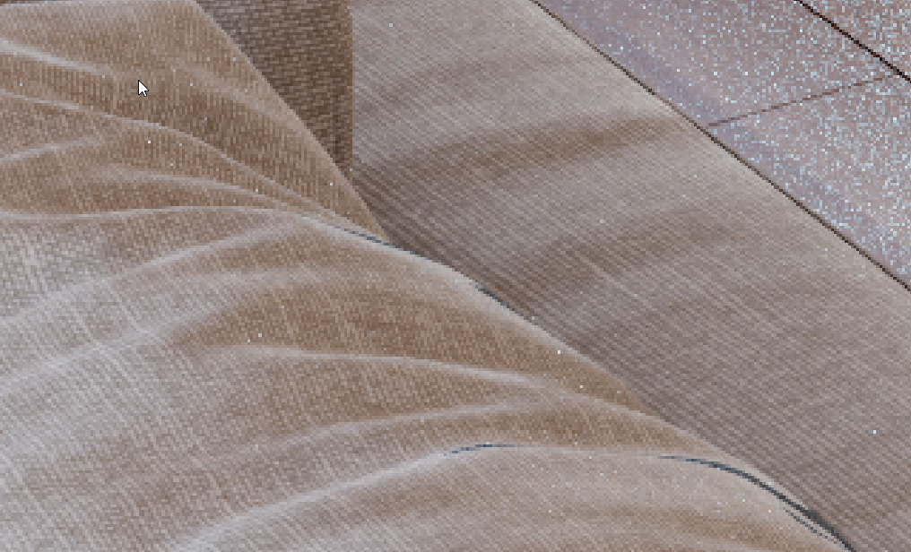

Non-Denoised:
Captura de pantalla de 2021-06-23 00-02-32.png (106.82 KiB) Viewed 22913 times
