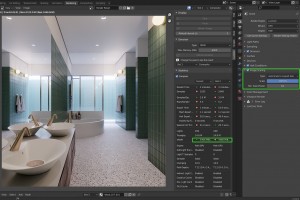

Even in a small scene like this it save me arround 80mb. Will test in a more complexe one :
