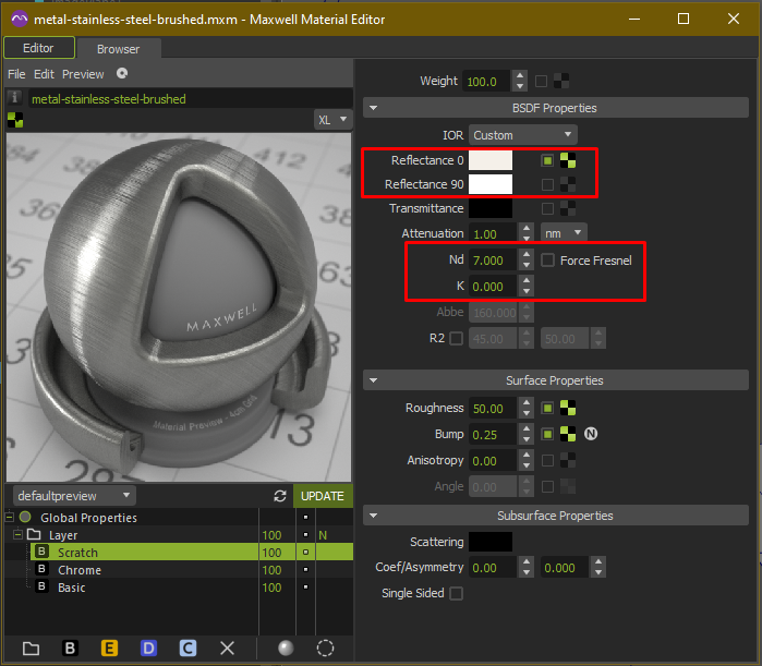

For me it seems like custom 'n,k' values in LuxCore are similar to Maxwell's 'Reflectance 0' and 'Reflectance 90' colors, so I'd name them 'custom n,k colors' in LuxCore (if I understand it right). And in Maxwell you can load some textures there instead of plain colors.
Maxwell has Nd and K fields separately, and those numbers have huge influence on material reflectivity Fresnel function. Actually Nd in Maxwell is actually the same thing as IOR, but it changes also reflection intensity for metals and other non-transparent surfaces. If you load SOPRA measured data files there - they override all layer BSDF properties, so Nd (IOR) and K (extinction coefficient) values as well as color data are taken from measured data.

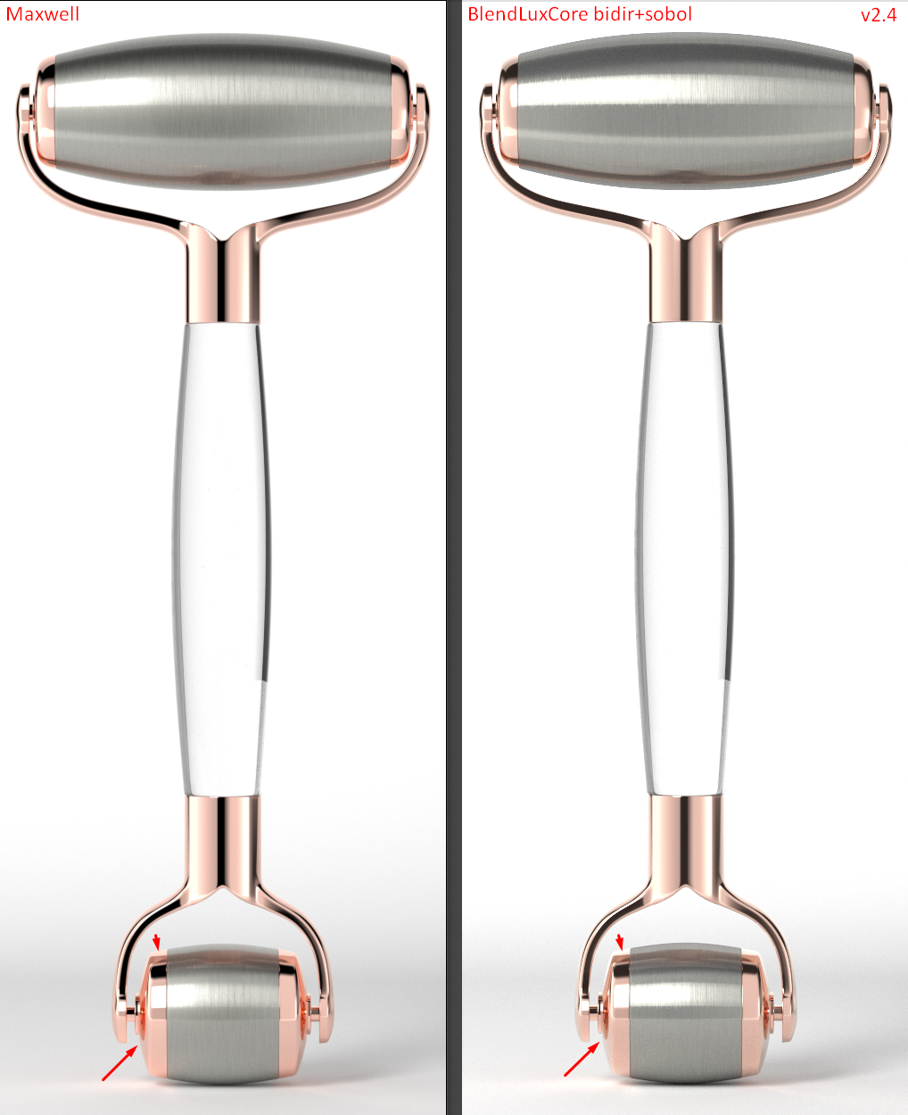

Though I can't achieve the same color with measured data or Copper preset so far.
The rendering times here were the same 11 minutes on my 80-threaded system.
Maxwell's image is a bit clearer from noise, I expected the opposite.
I used BlendLuxCore v2.4 here on the right.
Brushed metal is the subject for further tryouts to make it similar.
Although overall rose gold metal looks the same, but because of lack of some controls I was unable to achieve the identical look.
Some issues were with light materials setup as well. And I figured out that the mask textures for lights have to have gamma set as 1.0 in the image node.
BUT!!! It's pretty close to Maxwell and this is a huge achievement regarding the Maxwell's price tag.
Though, I'll make few other tryouts with custom n,k colors in latest release (and hopefully upcoming Nd, K numeric values in next ones if possible).
My preferred way to deal with Maxwell's reflectance values is by ignoring completely force fresnel and K. I use only ND (force fresnel off) in conjunction with R2 values, R0 andd R90. This gives me predictable variables and results and a good margin of intervention on the fresnel intensities.

But Maxwell's antialising is simply unbeatable...
Artistus
Posts: 6
Joined: Mon Jun 08, 2020 2:07 pm
Re: Metal Material
Post by Artistus »
daros wrote: Wed Feb 17, 2021 7:42 pm But Maxwell's antialising is simply unbeatable...
I don't know how it's done, but suppose they could be using floating point screen coordinates for sample color and brightness instead of some special filter and they could summarize all data for every pixel having samples more or less randomly distributed over it's screen area. This approach could avoid the need for any AA filter. But who knows...
Anyways, I'd do it that way if that was possible, but I don't know if it is.
