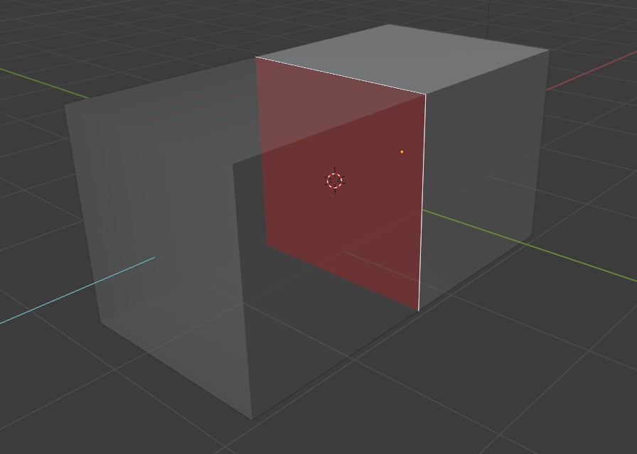

The remaining surface (marked in red) carries an interior and exterior volume as mentioned in this image:

With two faces deleted then there must only be three remaining faces? Can you show which two faces overlap each other?

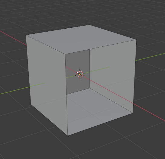

Imagine a cube and delete one of it's faces.
The result is kind of a shell, like this.
All remaining face normals point to air.
And another cube, that is turned into shell with deleted opposite face:
Both are connected by a single (not overlapping) face in the middle:
The normal of that face points to one of the cubes and that indicates the exterior volume.

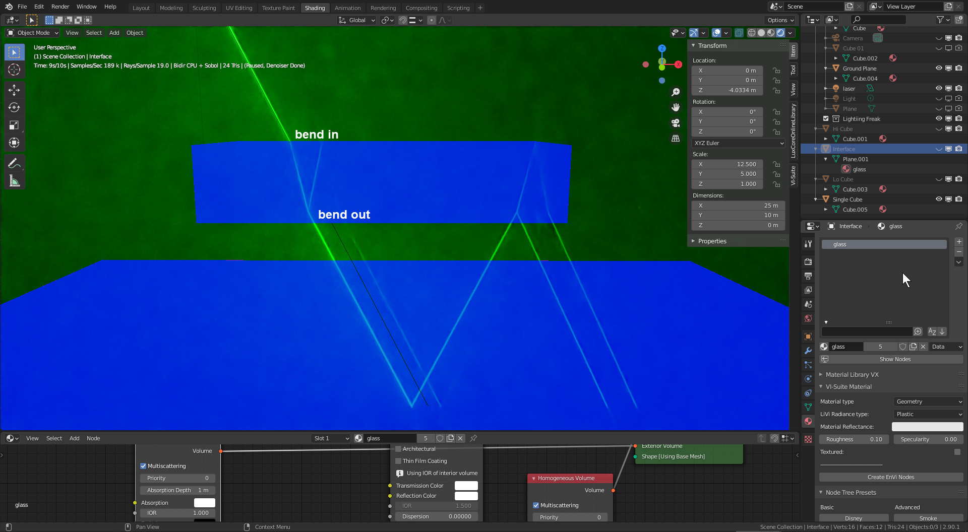

Reference Single Object - - Ray Tracing

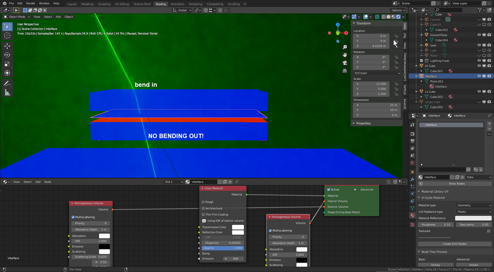

Your Original Test Scene Setup with Face Elements Spread Out - Solid Illustration

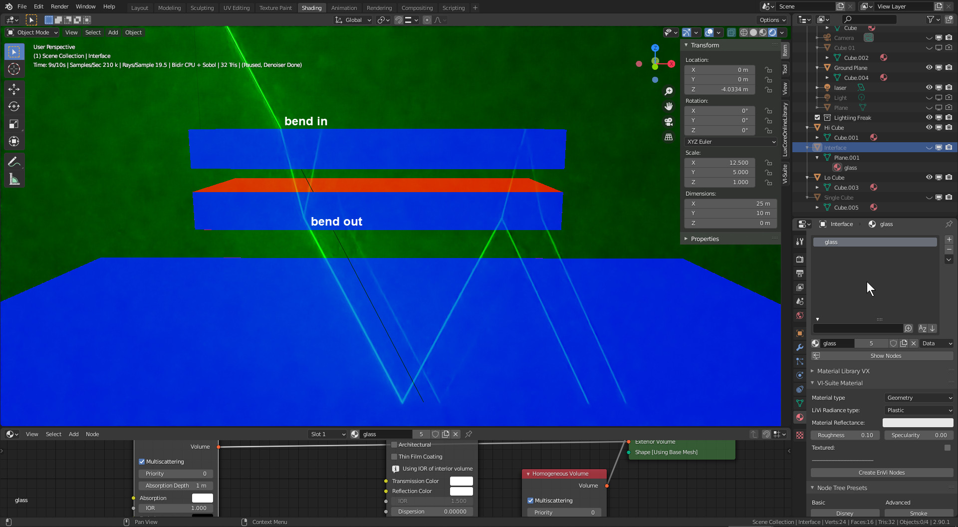

Your Original Test Scene Setup with Face Elements Spread Out - Ray Tracing
Less the Interface - Ray Tracing

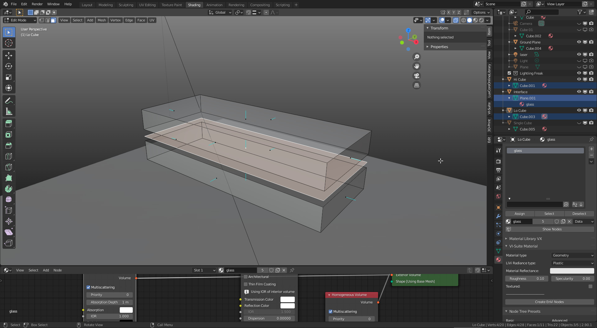

test scene with comparisons.blend
