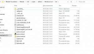

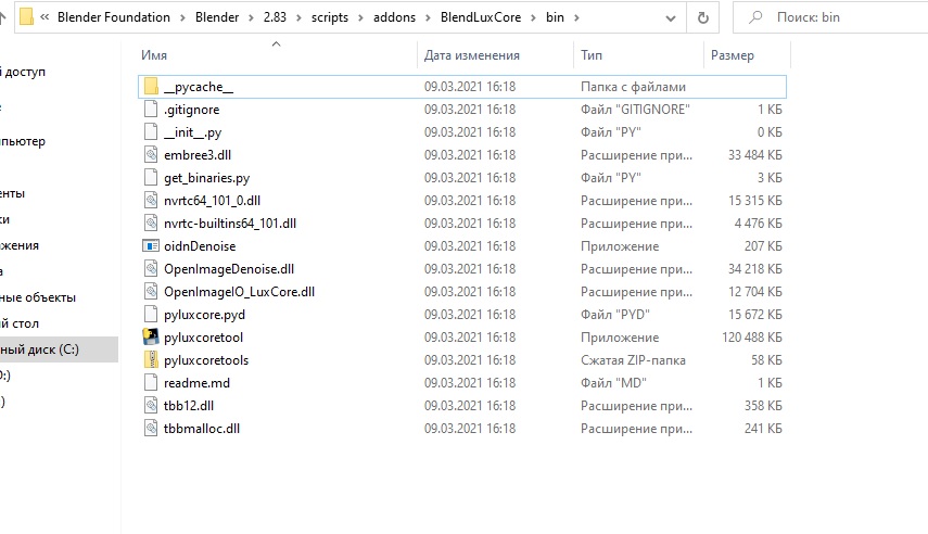

maybe it doesn't work in 2.83 blender version
AndreasResch
Posts: 135
Re: OIDN new version Out
Post by AndreasResch »
The problem seems to be 2.83 here. In 2.83 it doesn't work for me neither. It does in 2.91 and 2.92.

AndreasResch wrote: Tue Mar 09, 2021 1:38 pm The problem seems to be 2.83 here. In 2.83 it doesn't work for me neither. It does in 2.91 and 2.92.
Yep, I confirm on 2.92 everything works fine, thanks

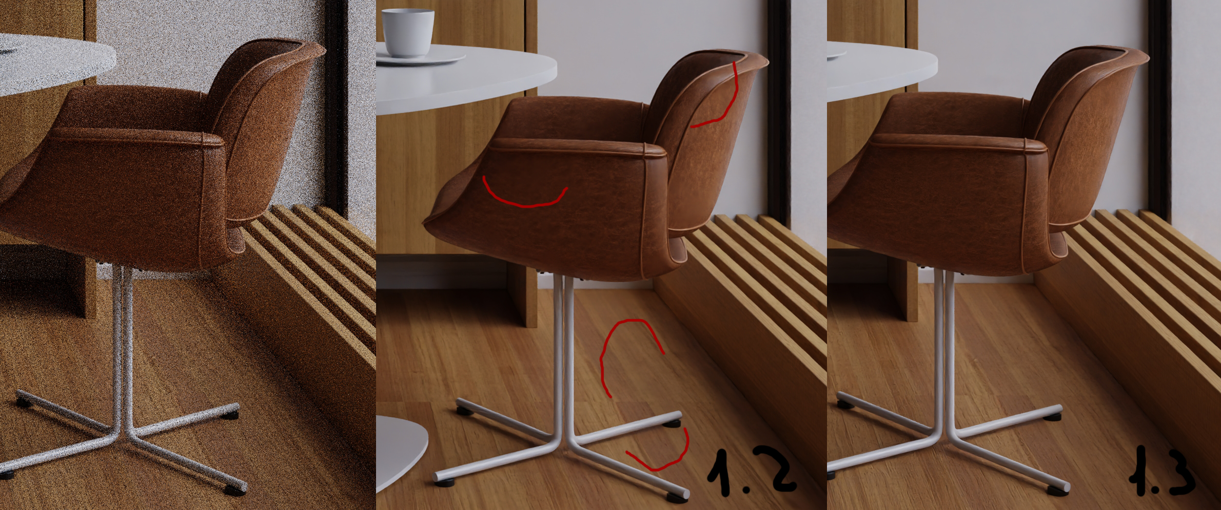

1.3 oidn is impressive!
Now there is no problem with blurred areas on some textures with details
AndreasResch
Posts: 135
I agree. The difference is obvious.

zuljin3d wrote: Tue Mar 09, 2021 1:26 pm maybe it doesn't work in 2.83 blender version
I notice you still have tbbmalloc.dll, can you try deleting that?
Also your OpenImageIO.dll is named OpenImageIO_LuxCore.dll :?
acasta69
Posts: 472
Post by acasta69 »
Martini wrote: Thu Mar 11, 2021 7:22 am Also your OpenImageIO.dll is named OpenImageIO_LuxCore.dll :?
That should be ok, we have renamed the library in Windows builds to avoid some compatibility issues for the 3dsMax plugin.
