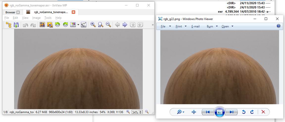

Thanks CodeHD for you answer.
Does it mean that I only need to add TONEMAP_LINEAR to image pipeline and scale it with 0.39 factor?

Thanks a lot CodeHD. Your solution is exactly what I needed. Finally exr is identical to png
I post the final pipeline code. Maybe someone will have the same problem
