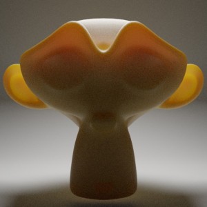

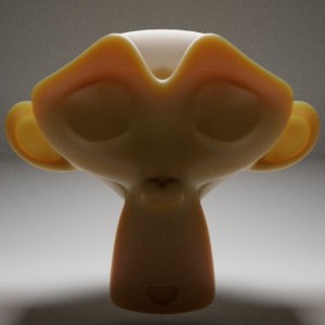

Sharlybg wrote: Tue Nov 03, 2020 6:13 pm Can you just make a simpe scene of your Cycles SSS applied to luxball so that we can just convert it to Lux for you ? :idea:
There's no special node setup. Here's how the SSS material looks in Cycles:
Thanks in advance if you want to give it a try.

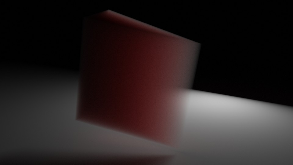

Cycles
Cycles
I am not totally sure how to translate Cycles subsurface radius to LuxCore terms, so I just eyeballed the following and it seems to match:
  • Material null (so I can concentrate on the volume only first).
  • Homogeneous volume.
  • Multiscattering enabled (can't match Cycles otherwise, the volume stays too dark).
  • Absorption color set to the same red as Cycles.
  • Absorption depth is the max. thickness of the cube, 0.8 m.
  • Scattering color white.
  • Scattering scale 10.06.

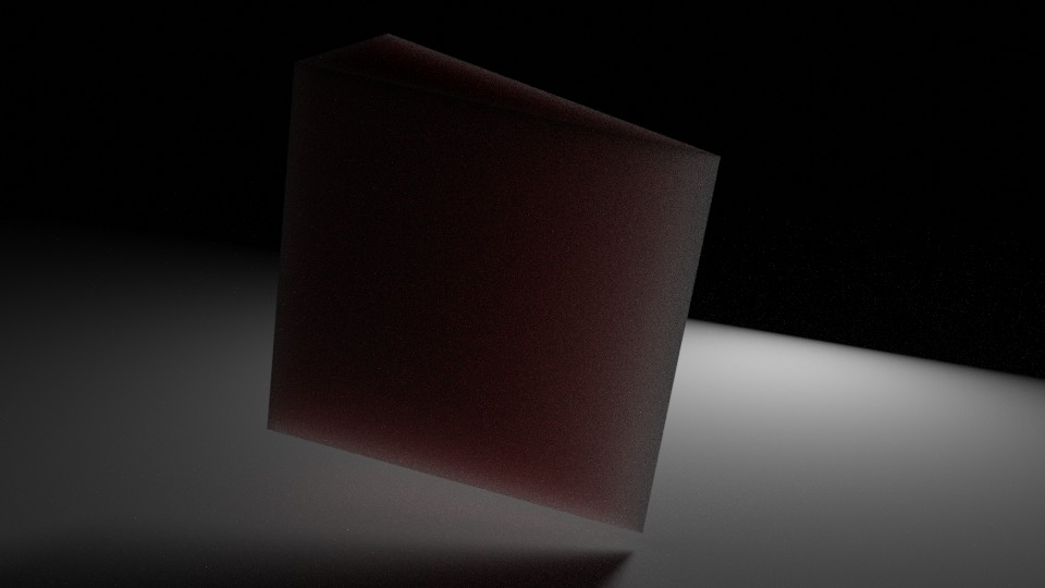

Lux, only volume (null surface)
Then, I tried to add the surface material. I think the most fitting thing would be glossytranslucent here, but even with diffuse color = black and transmission color = full white, it darkens the result considerably.
Lux with glossy translucent surface
Note also that the path depth is important. Below a depth of 14, you can see visible darkening in the volume. I set the depth to 16 for all ray types in LuxCore.

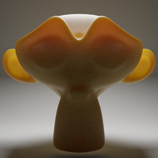

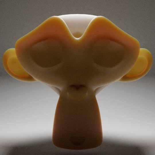

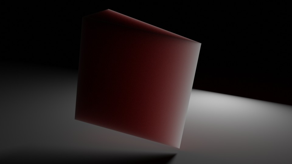

Ok i've done my test here is what i have :
LUX
Cycles
Blend
SSS.blend
(867.66 KiB) Downloaded 914 times

Everything is correct. Great example, Sharlybg!
Luxcore has absolutely amazing volumes.
Need to retrain with Cycles.

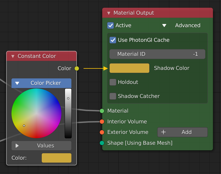

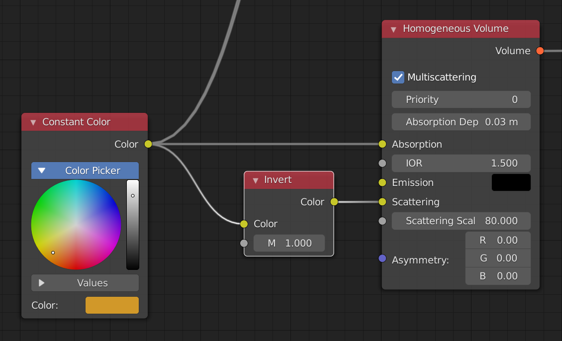

Sharlybg, I'm curious why you used an Invert node in your SSS setup:
Does the Scattering color absorb that color inside the volume, in stead of scattering it?
Also, a smart move to lighten the Material Output Shadow Color. That's one thing I forgot to try.

One more thing: I'd love to see a color input slot in the Material Shadow Color:
Thanks.
