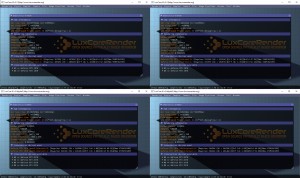

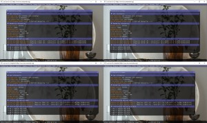

More testing with different scenes, all rendered without CPU, PGI or denoiser:
Ratios of amounts of samples per second:
Food scene............................Wallpaper scene:.................Benchmark scene:
2.4 CUDA/2.4 OCL=1.26......2.4 CUDA/2.4 OCL=1.25.....2.4 CUDA/2.4 OCL=1.23
2.3 OCL/2.4 OCL=1.85........2.3 OCL/2.4 OCL=1.02........2.3 OCL/2.4 OCL=1.32
2.2 OCL/2.4 OCL=2.22........2.2 OCL/2.4 OCL=1.71........2.2 OCL/2.4 OCL=2.16
2.2 OCL/2.3 OCL=1.20........2.2 OCL/2.3 OCL=1.67........2.2 OCL/2.3 OCL=1.63
In a light scene with simple materials like the Wallpaper scene there is nearly no speed difference between v2.3 OCL and v2.4 OCL.
In a heavy scene with more complex materials like the Food scene there is a huge difference.
V2.2 is always faster than v.2.3 and way faster than v2.4.

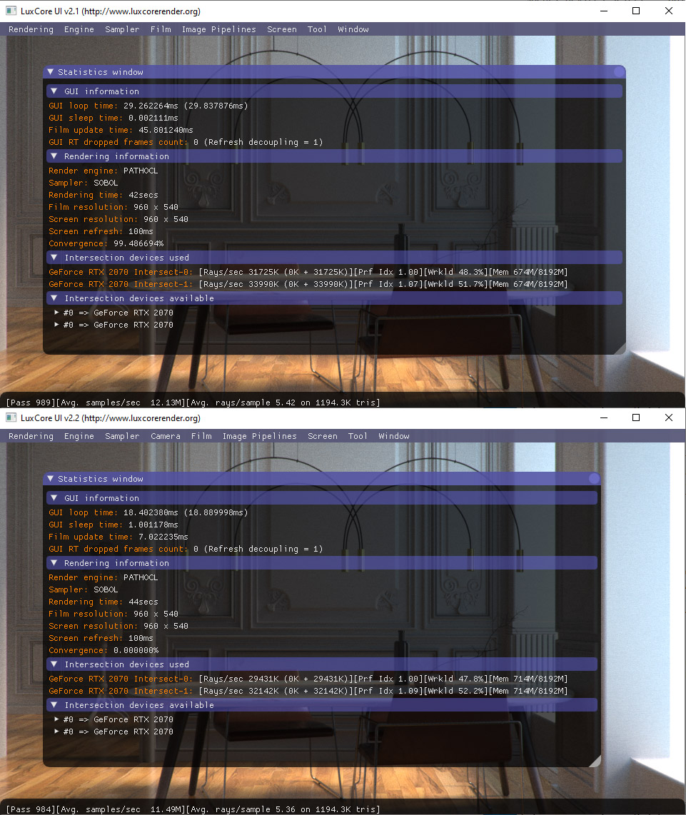

OMG I forgot to compare against v2.1!!
It renders even faster than v2.2
But only a little bit
Rendered with no PGI (didn't exist in v2.1).
Now I dare not to try v2.0 . . .
