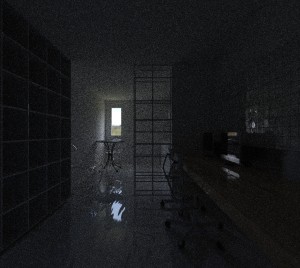

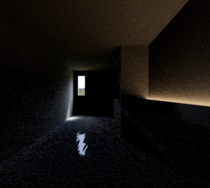

Look like Env_Cache is broken in luxcore 2.4 master :
ON
OFF
Re: 2-Levels Env. Light Visibility Cache
Sharlybg wrote: Wed Mar 18, 2020 2:26 pm Look like Env_Cache is broken in luxcore 2.4 master :
How :?:
How :?:
Result are noisier and darker while using Envcache.
Just trying to reproduce the behaviour with a simpler scene.

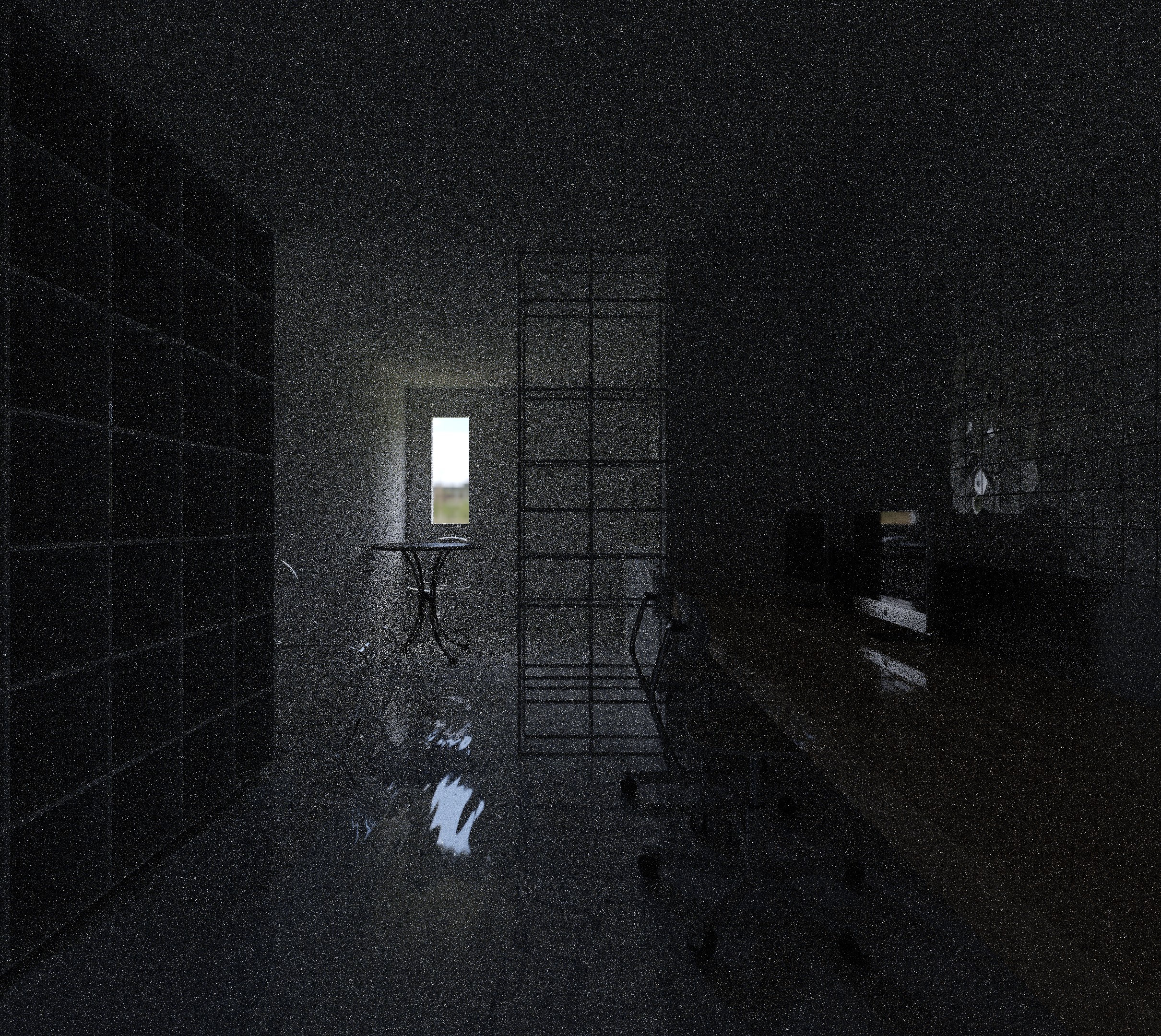

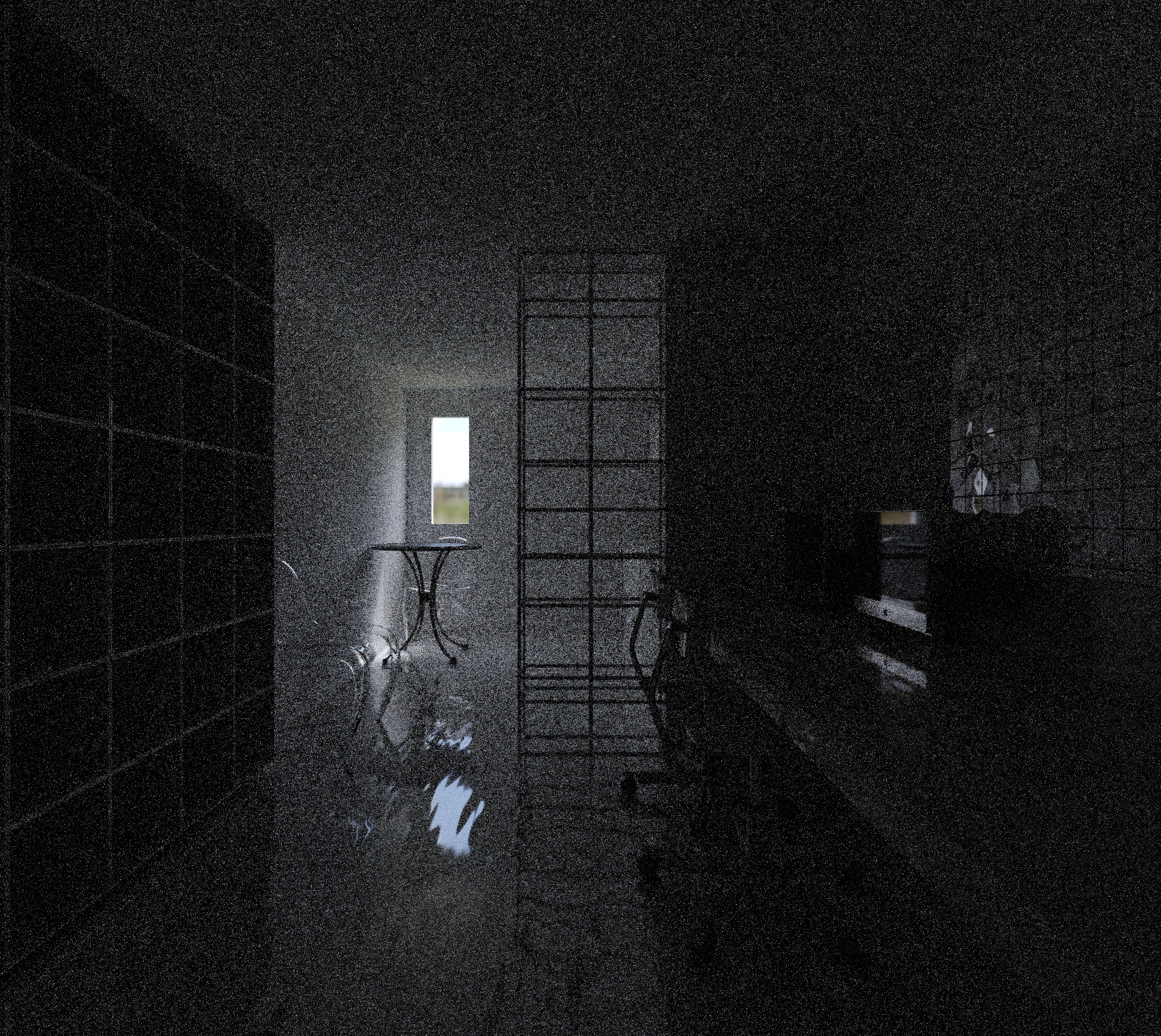

This is my tests
Env Cache OFF
Env Cache quality 0.5
Env Cache quality 1.0
Enc Cache quality 0.1

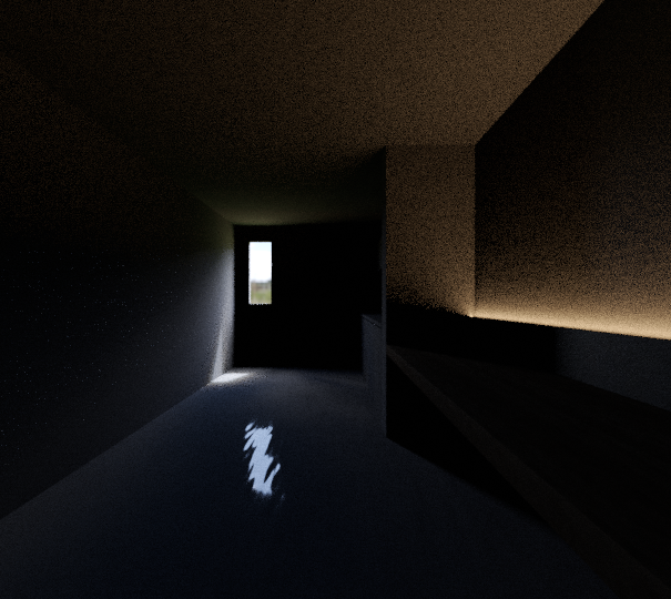

Most noise in this scene comes from indirect light, which is not accelerated by env. light cache (use PhotonGI instead).
This is the result when I set max bounces to 1 (only render direct light):
with env. light cache
without env. light cache
