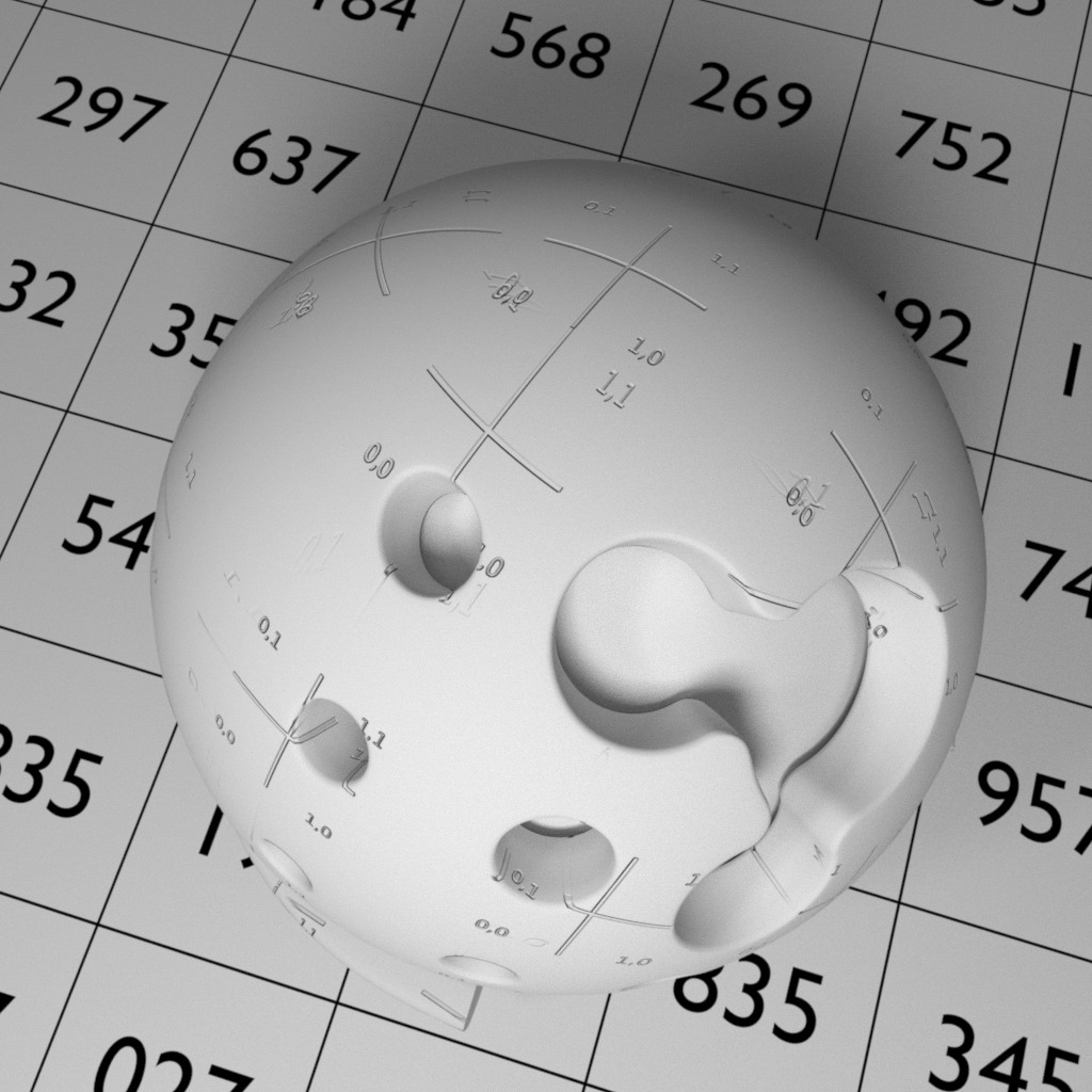

It seems to work fine here:
The mapping direction is also consistent among sides (notice the 0,0 => 1,1 position on side, top, etc.):
How do you trigger the problem ?

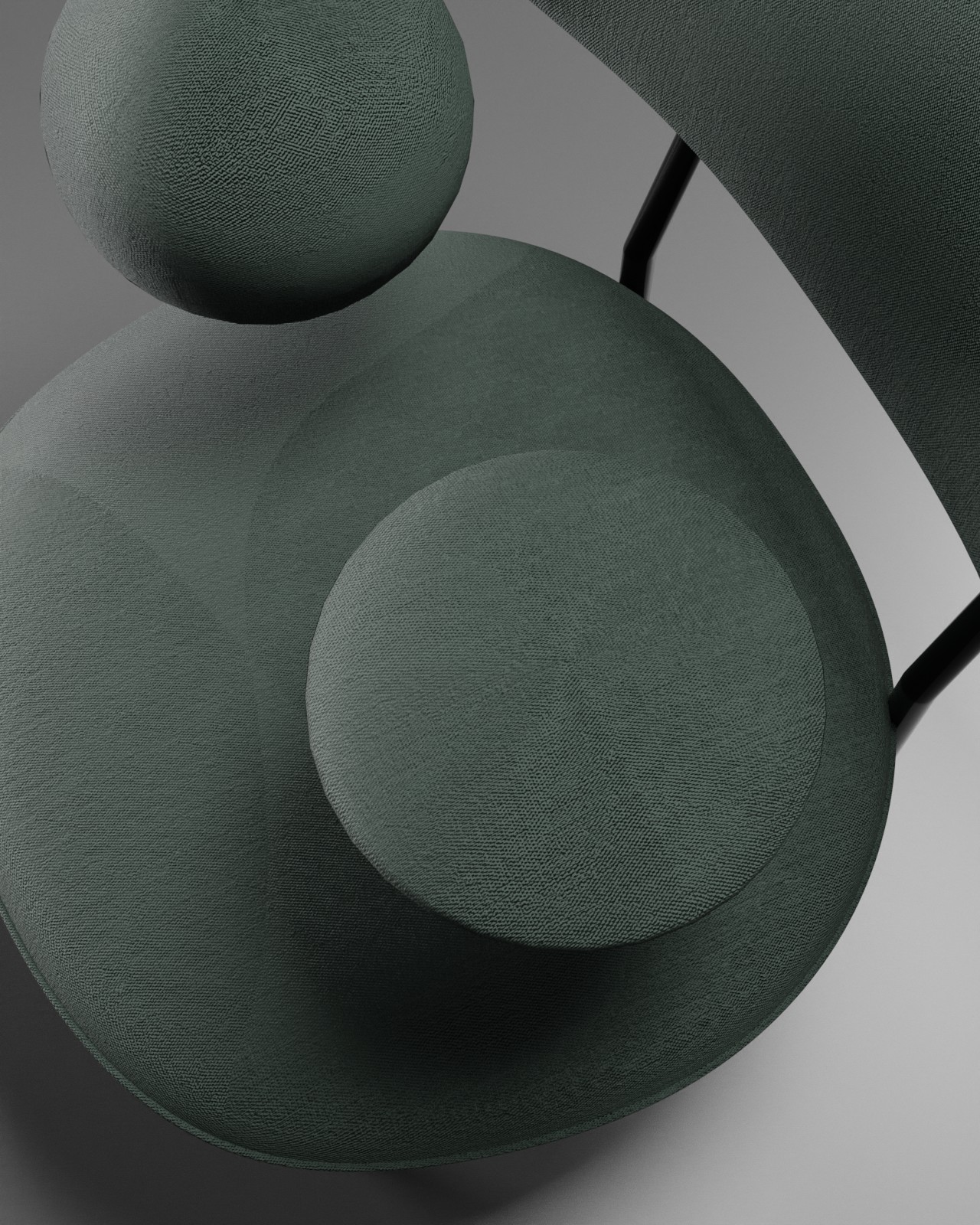

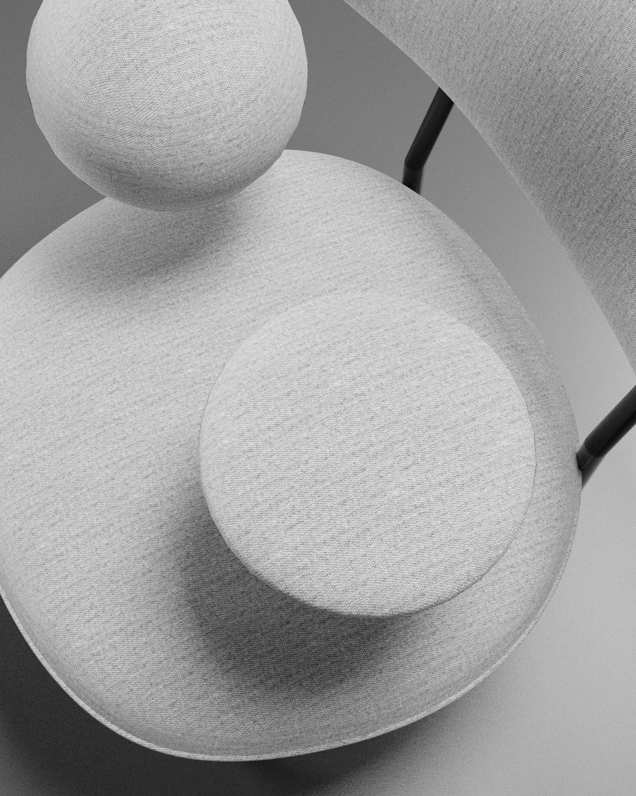

lacilaci
Posts: 1969
Post by lacilaci »

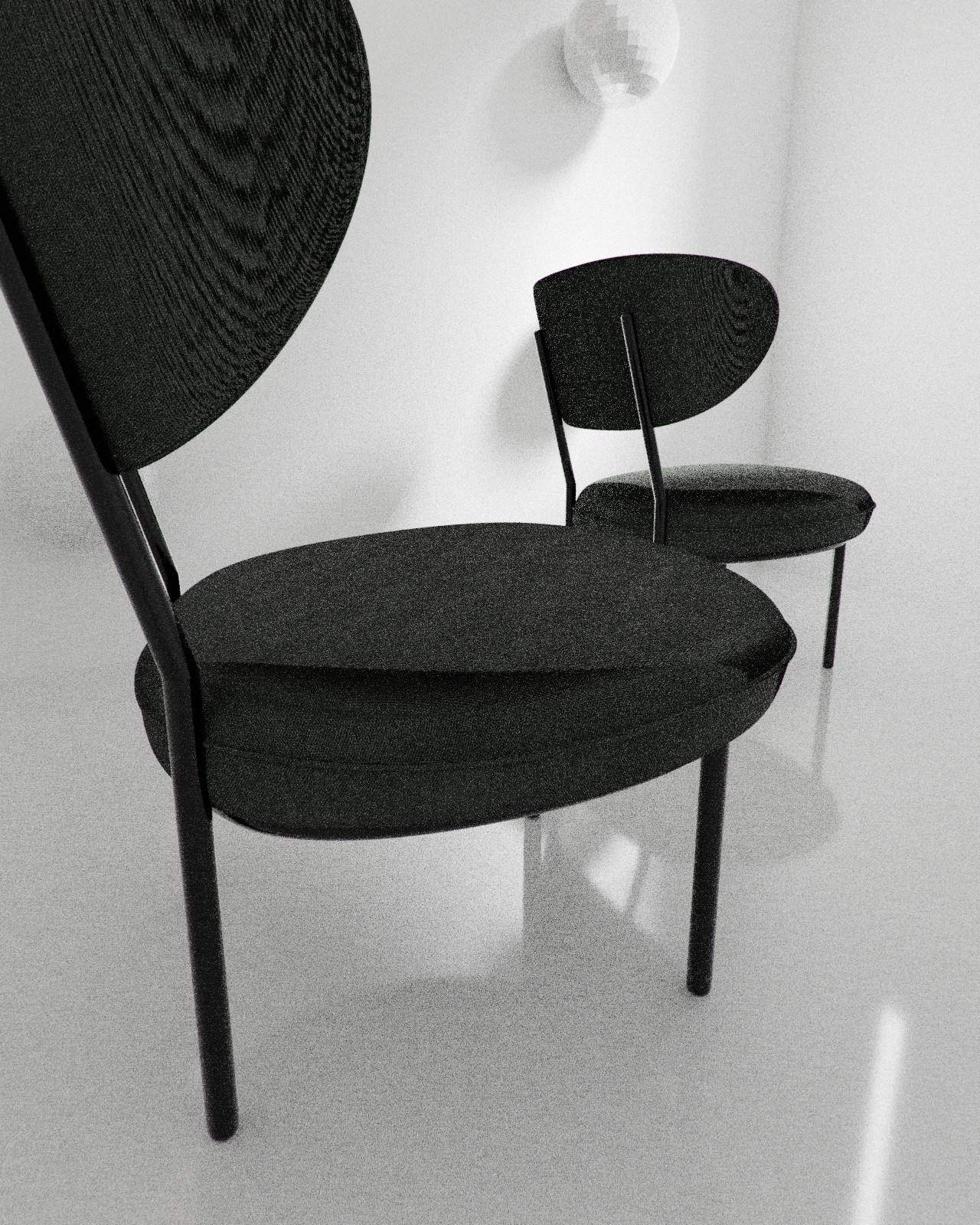

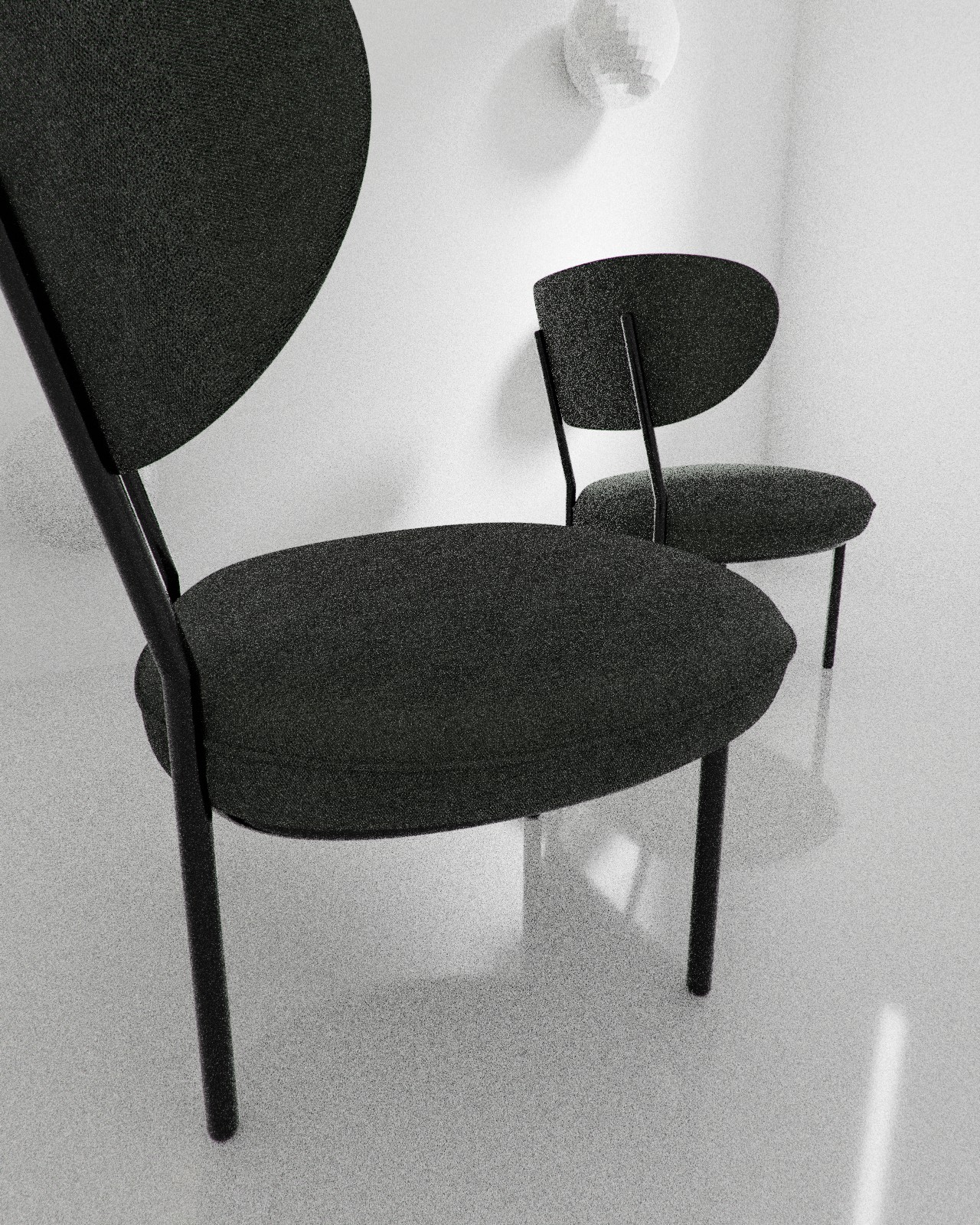

Another issue with this, related to opencl
opencl
cpu
scene is a mess cause I'm testing animations in it chairs are instances and parented to empty objects that are animated(rotation). Cpu seems to handle it ok but opencl somehow freaks out.
here's quick animation, where you can see almost as if one side is missing projection or something(it's near black) on cpu this doesn't happen
vid.mp4
(468.45 KiB) Downloaded 792 times
I can't share the scene cause of the chair, but I might try to replicate this on a primitive object tomorrow... If I can.
By the way, the scene has a bakeg gi, but none of chair materials are using it (so that it is stable during anim.) if it's of any significance.
EDIT: this is definitely related to animation, cause when I move camera it looks ok at first but when I slide animation and render another frame then again a side of the object goes black. Maybe it's because chair parts are parented to the animated object? So might be related to how the hierarchy is exported from blender?? IT's however unrelated problem to the original bump mapping seam

So the first problem seems to be related to high repetition or high frequency of details in a texture.
The second one, where the whole triplanar map gets weird is probably due to animation and parents..
the scene is set to render mid animation frame so you should clearly see all what's going wrong.
