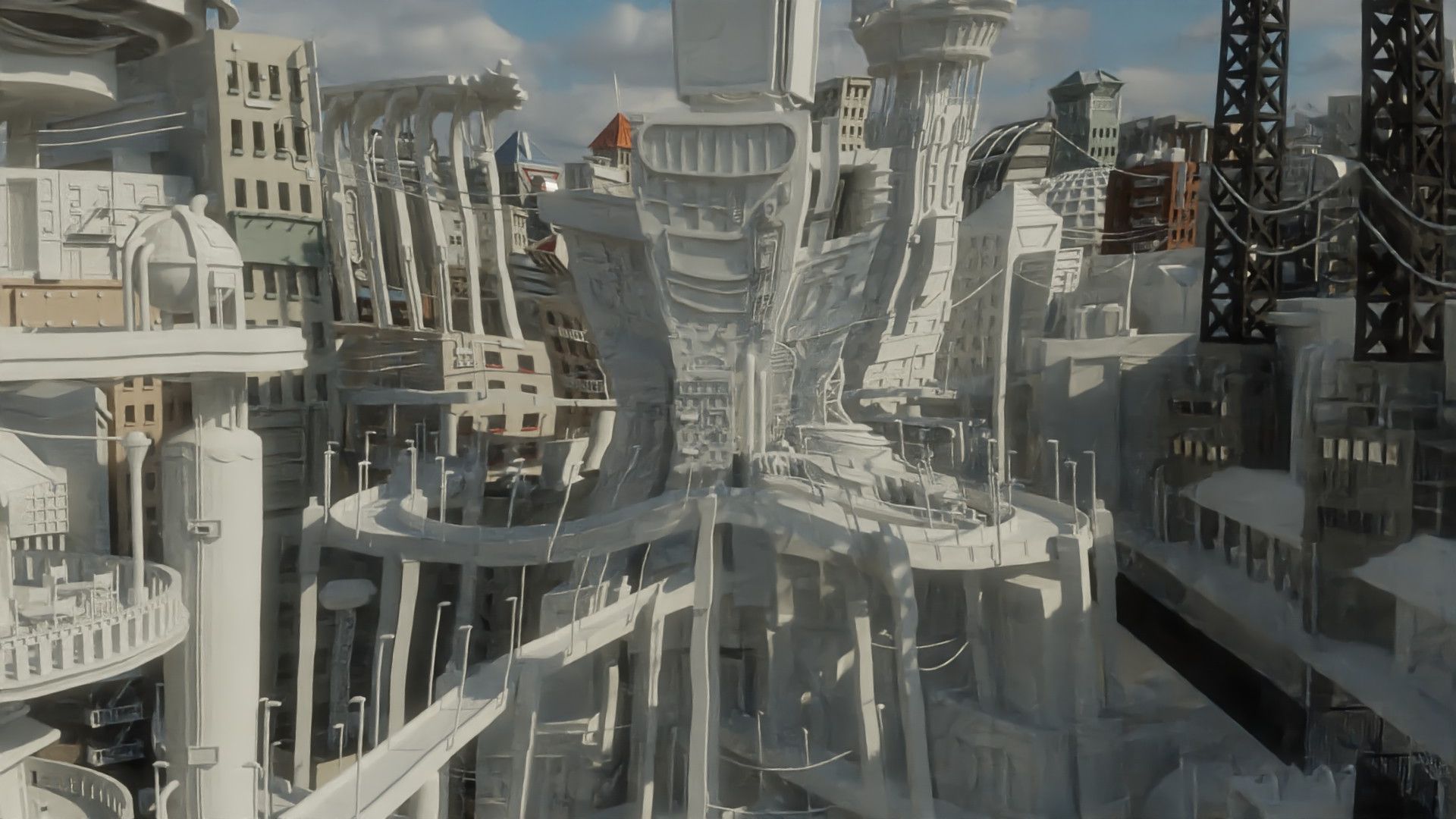

Tried rendering with lens. I didn't know how exactly lens are in real camera, so I downloaded free model to have some reference.
I managed to get actual image.
I guess lenses in this model aren't very accurate. I need to replace it with good lenses from plugin.

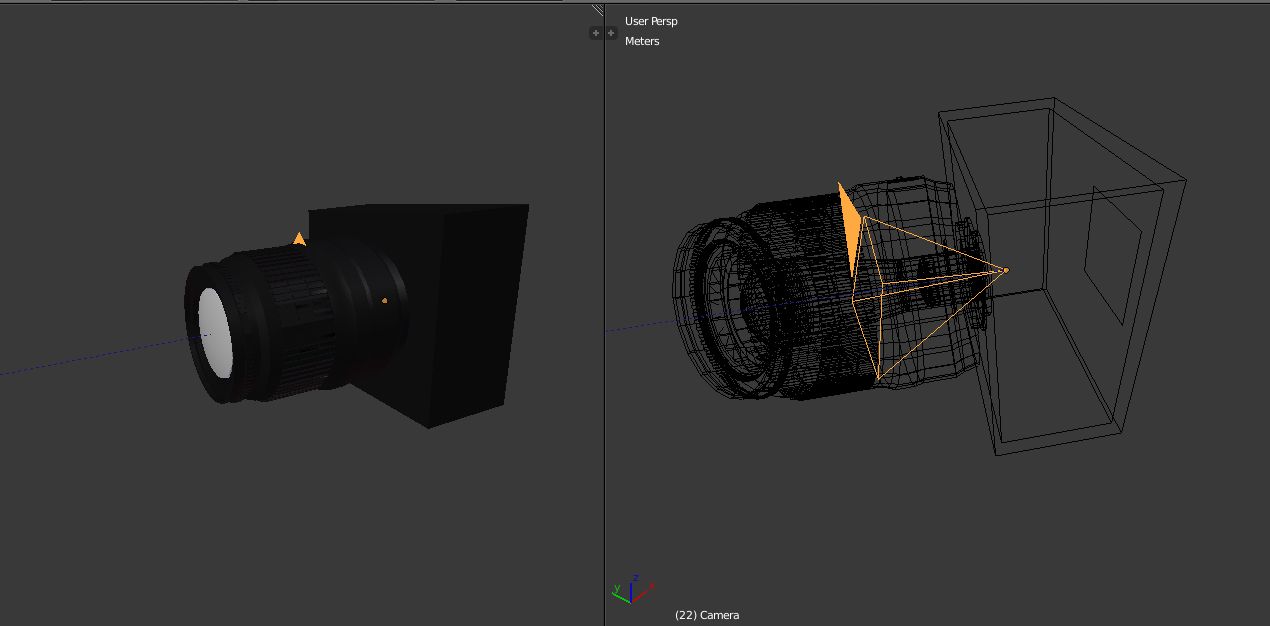

Here's the camera:
