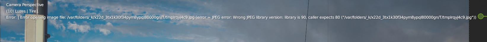

EDIT:Maybe I spoke too soon:
Gonna revert back to previous version to see what's the matter.

(error = JPEG error: Wrong JPEG library version: library is 90, caller expects 80
Is only present in this new Mac build, both in 3.3.2 and 3.4.1 - Reverted back to the old version and all is well in 3.3.2
Just to make it clear: I did go trought all the steps, disabled LUX,restarted Blender, deleted LUX, deleted "luxcorerender.org" folder and restarted Mac before installing new build, compiled kernels and it works.But stalls on that error if scene has JPGs.
I'm on 12.6.2 on a 2013 Mac Pro but will retry at home on iMac.
u3dreal
Posts: 563
Location: Ulm
Re: LuxCoreRender daily/automatic builds
Post by u3dreal »
Oh no i hate compiling ... need to recompile the whole dpes ... there was a wrong jpg lib sneaking in there ..
give me another day
