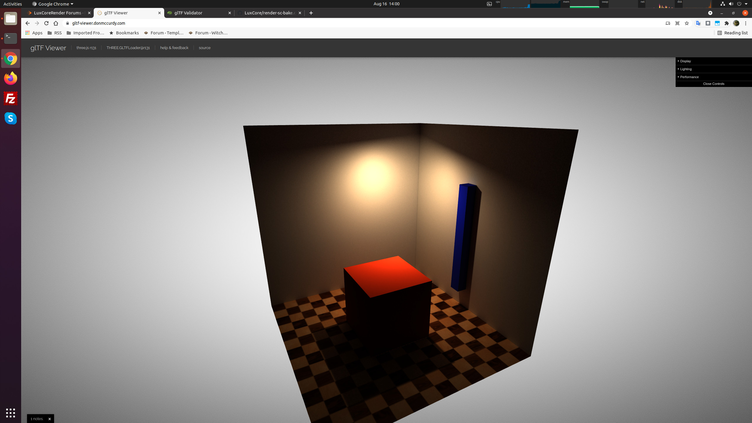

It is working fine here: unpack the .zip, drag the unpacked directory on https://gltf-viewer.donmccurdy.com/ and it worksu3dreal wrote: Sun Aug 15, 2021 10:32 am You can find the gltf exported from luxcoreui here
http://q3de.com/wp-content/uploads/2021/08/testbake.zip
The https://github.khronos.org/glTF-Validator/ also works fine (it is only complaining of not begin able to find the not uploaded .png).
I need a description of how to replicate your problem.
Yes, the denoiser work, you can find an example of usage with light maps here: https://github.com/LuxCoreRender/LuxCor ... ke.cfg#L39
Note: you need also to use the BAKEMAP_MARGIN image pipeline plugin to avoid the annoying border on the edge of objects.
Note 2: you have also to be careful on how to configure image pipeline gamma correction because you may end with gamma correction applied two times when exporting in glTF.

Strange. Import into Blender or BabylonJS does not work ...
Could you try it with Blender ? That is where i got the error..
Also here in babylonjs sandbox there is a json error when i drop the folder there.
https://sandbox.babylonjs.com/
In gltf viewer it works for me as well. Strange that treejs works and babylon doesn't.
I think it is just some format of the text file since Blender throws an
binascii.Error: Incorrect padding
It is the same in macos and windows so i doubt it is a big/lttle endian problem.
So you should get an error when inporting to Blender 2.93.2

It could also be a python problem ..
https://stackoverflow.com/questions/458 ... tiple-of-4
https://gist.github.com/perrygeo/ee7c65bb1541ff6ac770

I added the work around and it should have fixed the problem. The Blender import now works.u3dreal wrote: Mon Aug 16, 2021 12:37 pm It could also be a python problem ..
