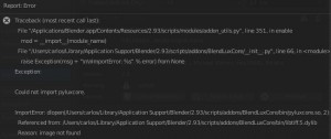

I must be doing something wrong on my side because I simply can't get Luxcore add-on to be enabled.
I deleted Blender 2.92, deleted all Luxcore install files. Downloaded Blender 2.93 and the latest BlendLuxCore build Today ( June9th).
I can install the plugin, but every time I try to enable it it shows the following error:
I had 2.5 working with no issues on Blender 2.92 with GPU support but.... well you know, there is a newer version so I upgraded...
I have tried to install the Master and replace the Bin files, did not work, Install the Latest build, will not enable.
I'm on a Mac Pro
OS 11.4 Intel Xeon E5. 64Gb Ram
Dual AMD FirePro D700
Any ideas on How I can get this working again?

Carlosmpa wrote: Wed Jun 09, 2021 7:13 pm Any ideas on How I can get this working again?
Try to check if you have the mentioned missing file (i.e. "libtiff.5.dylib"). I don't have a a Mac but I downloaded the .zip and it looks like the motioned file is there.

Thanks for the reply. I checked the installed folders and both of the files mentioned in the error are in the folder, so I'm not sure why the error says it can't be found.

So I found the solution to this and I thought I'd post in case anyone else runs into this same issue. it was a lot simpler than I thought.
The "scripts" folder was created with Read Only permissions. Once I changed the permissions for admins and system to be Read and Write then Luxcore installed successfully.
I found someone with a similar issue and the solution in this thread.
https://developer.blender.org/T77962

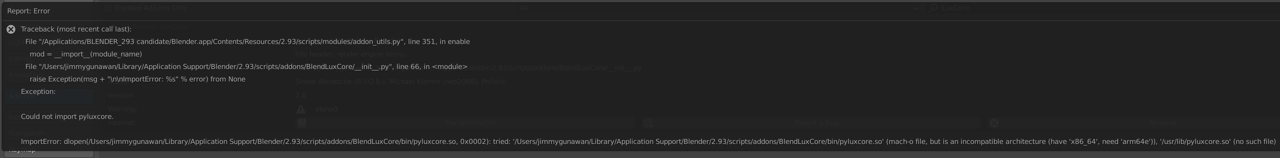

As for today, I can confirm it still does not work with macOS Monterey, M1 iMac, Blender 2.93. But 2.92 version works.
