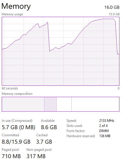

I had 2 memory spikes which capped my 16GB RAM when building with 2 cpu's.
On a single core it barely made it (using around 8 GB of memory during most of the building process)
I guess it's time to close chrome when building or download more RAM :')

Do you have a swap file ? You may need one to enable virtual memory.
theoharkes
Posts: 7 Joined: Fri Feb 05, 2021 4:17 pm
Post
by theoharkes » Fri Mar 05, 2021 1:40 pm
Dade wrote: Thu Feb 25, 2021 2:17 pm
Thanks a lot for pointing that out! I may have tempered with those before, as it seems the page and swapfile are not setup properly
