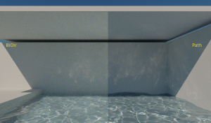

But I realized what the issue was/is. Basically I was checking BiDir with newly added caustics cahe (SDS paths) on "pool tester scene" where discrapency showed. I found it is caused by single scatter Specular material. And of course BiDir engine shows it brighter since it traces both ways. To compensate that in Path engine I had to make shadows 2/3 transparent, but then BiDir also renders way brighter, so I guess until there's no multiscatter for Specular materials (glass, mirror, metal) results between BiDir & Path won't match.
Still, an Indirect Light Cache multiplier would come in handy. (In same way as does Exposure Value ;)
Also then, Indirect Light Cache available for BiDir would make renders less noisy/faster.

kintuX wrote: Tue Jun 08, 2021 11:20 am But I realized what the issue was/is. Basically I was checking BiDir with newly added caustics cahe (SDS paths) on "pool tester scene" where discrapency showed. I found it is caused by single scatter Specular material. And of course BiDir engine shows it brighter since it traces both ways.
I'm not sure to understand what you mean with "single scatter Specular material": something like mirror (single scatter) Vs. glass (2x scatter, reflect and transmit) ?
Anyway it sounds like a bug in BiDir with some very specific type of path being rendered 2 times, I have to check.
