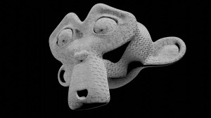

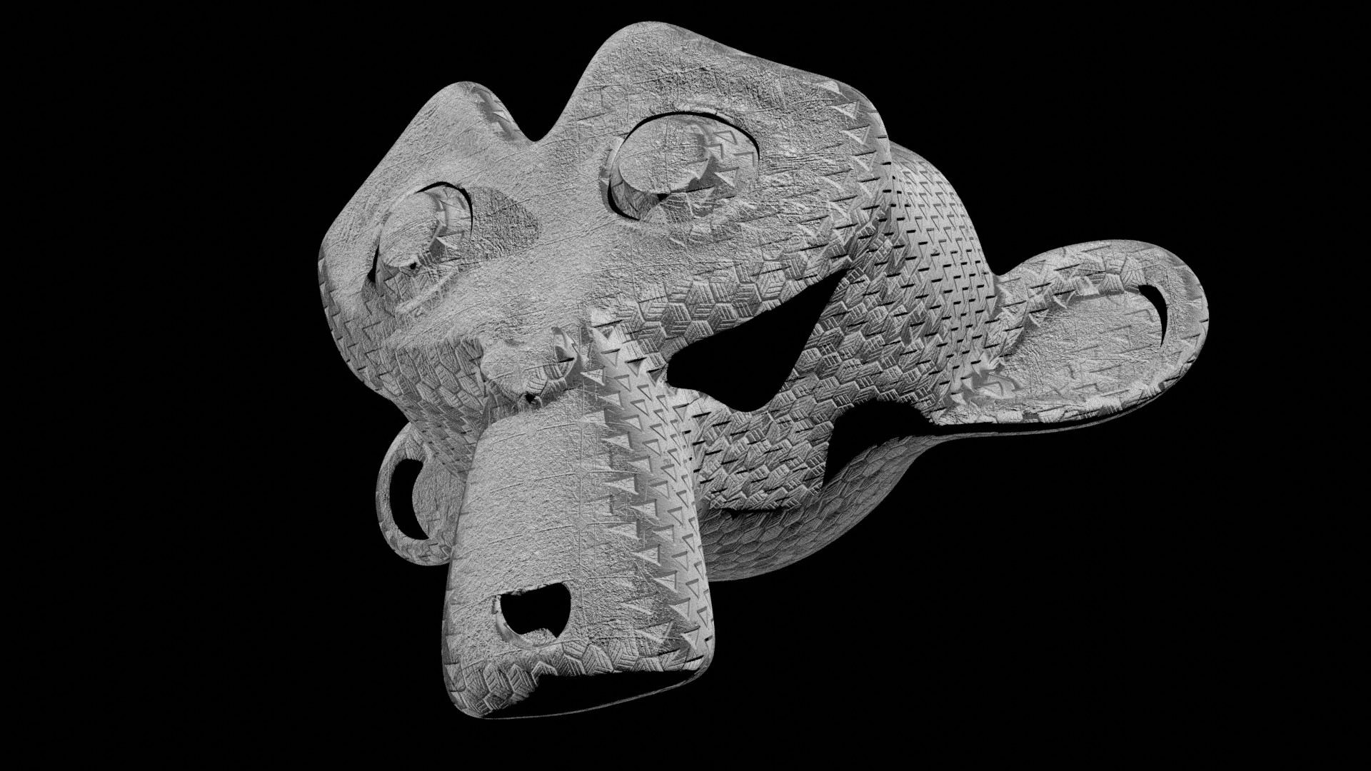

Dade wrote: Tue Jan 14, 2020 8:05 pm
kintuX wrote: Tue Jan 14, 2020 4:56 pm Q: Is there any control to manipulate the overlay blending like it can be done with Cycles (Blend value)?
At the moment it is a double square blending (i.e. quite fast) but it is easy to add different types of blending if needed.
This type is fine. What I meant by Blend value is the influence of it, from 0 (no XYZ blending) to 1 (full XYZ blending). And now when I think about it, blending distance and/or yes, different types or even masking (using texture or a procedural noise, if possible) I'd find quite beneficial 8-)
Especially, since I found out it works really good with displacement :D
Although again, here's incoherence between CPU vs OCL:
- CPU
- OCL
Scene attached here.

kintuX wrote: Tue Jan 14, 2020 9:51 pm Although again, here's incoherence between CPU vs OCL:
- CPU
- OCL
I have investigate the problem and, unfortunately, setting the bump height to 1 is not enough for OpenCL code, the triplanar texture must be really plugged directly into material socket. With OpenCL you are getting the normal bump mapping because of the scale node between the triplanar texture and the material (even if the scale value is 1, this trick to neutralize the node only for CPU code).
