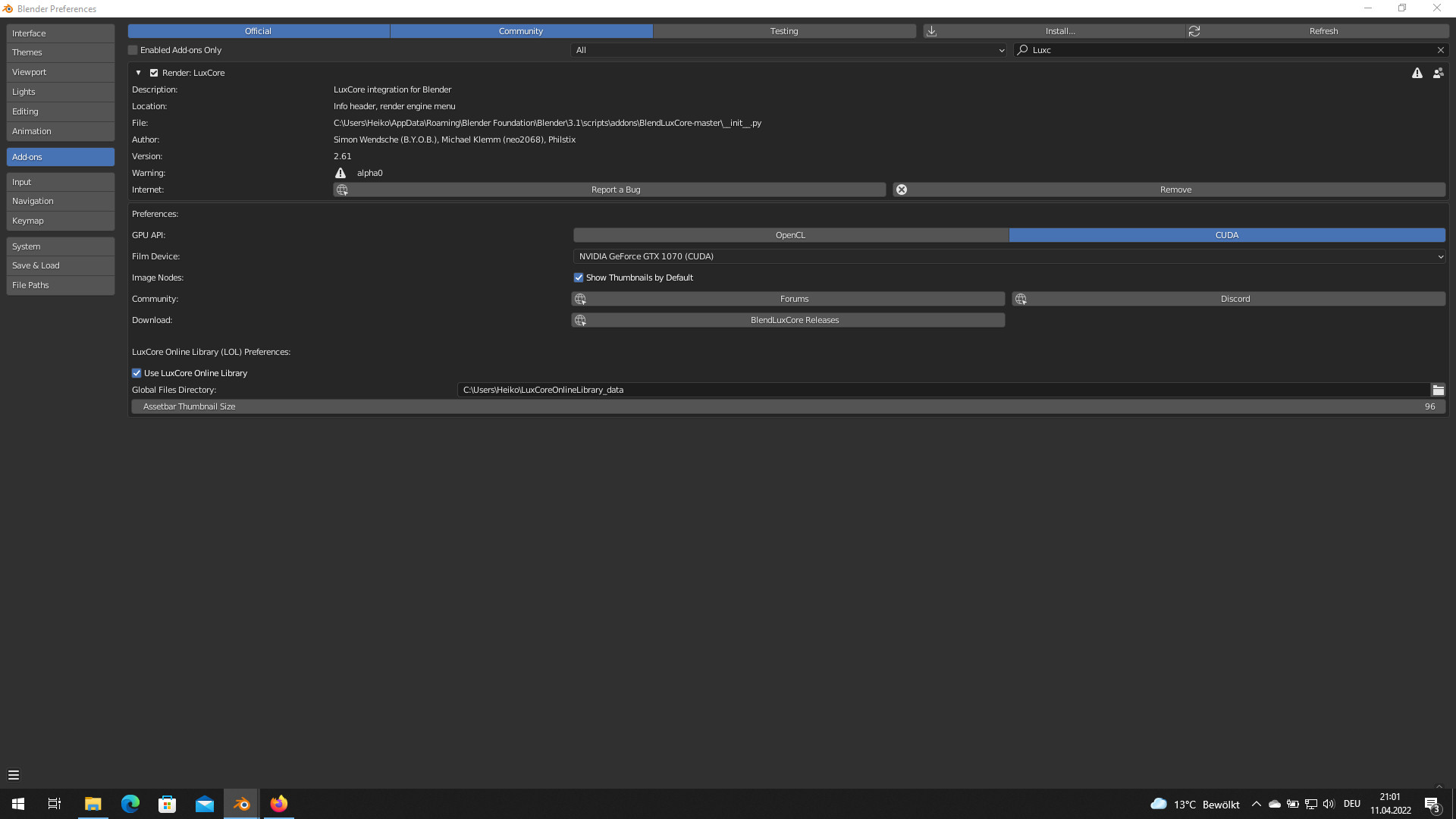

Can you please show your blender addon pref.
And does it happen with CPU only render too ?

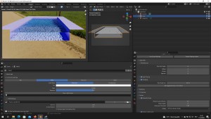

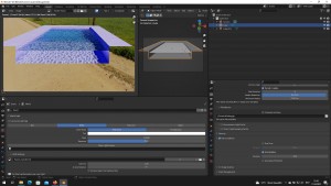

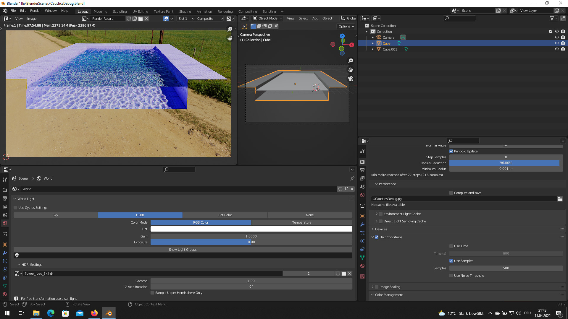

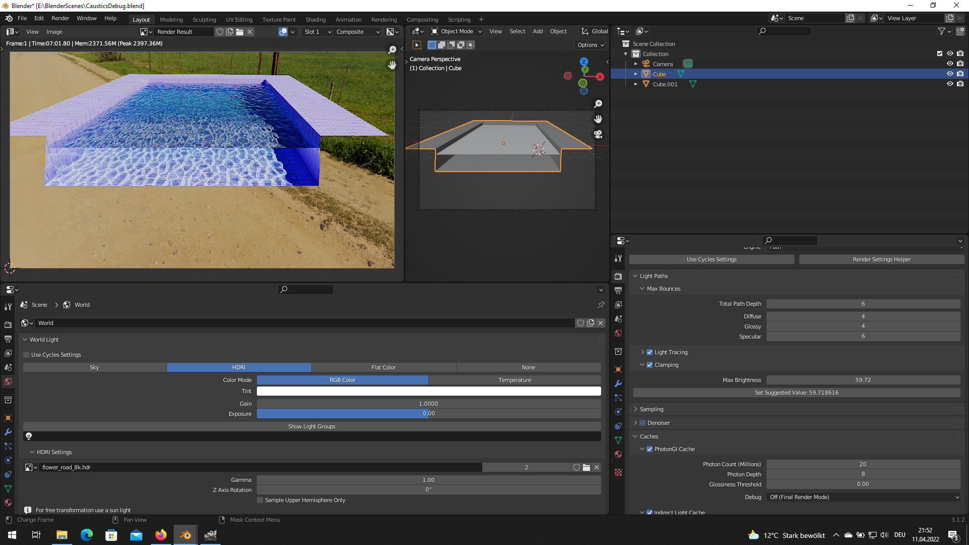

Hmm...not really. With LT on, Caustics will be reflected on the walls. Caustics will then usually still be visible through glas, water...
At least here:
Light Tracing off:
Light Tracing on:
This was the only scene I got it working - and I don´t know why. Like an invisible switch somewhere...
