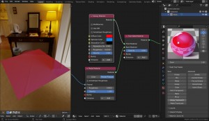

Odilkhan try putting something to be reflected in both sides, i don't see anything reflected in the blue side which is the backface.
The backface reflection is broken in general for the disney and glossy material in version 2.62.1a , it's not only a problem with the 2sided material, just
assign a disney or glossy material (not with 2sided material) and see that reflections don't appear in the backface.
Even in version 2.5 the backface can only produce reflections with a disney material and not with the glossy.
Two side shader reflection broken ?

Odilkhan the metal and mirror material work, I was talking about the disney and glossy material.
In my example both planes have the same material, as you can see the horizontal plane has no reflections.

Hm, I got it now. It doesn't work not on latest build but also on previous builds too. It seems it doesn't works with Glossy, Glossy translucensies mats.Luximage wrote: Fri Dec 23, 2022 1:49 pm Odilkhan the metal and mirror material work, I was talking about the disney and glossy material.
