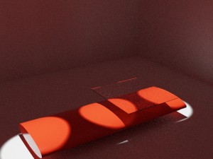

Here i completetely removed the box
Bidir on cpu
The shadow you see behind the glass is correct but the one you see directly projected on to the red object is solid, which is wrong.
Isted if you do the same using PhotonGI you should get the other behiaviour i described in my previous post.

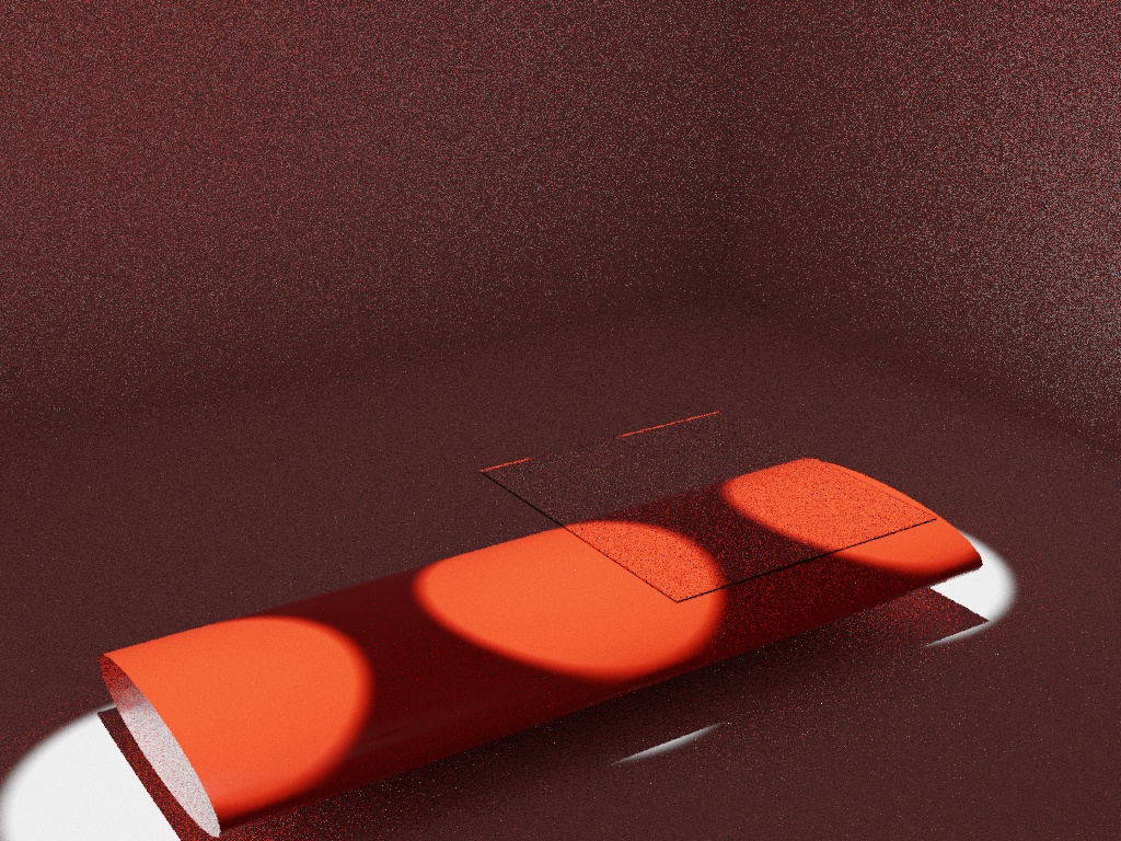

aha, bidir has too high PGI Glossines treshold set so no SDS paths
now, results match
(disregarding brightness)

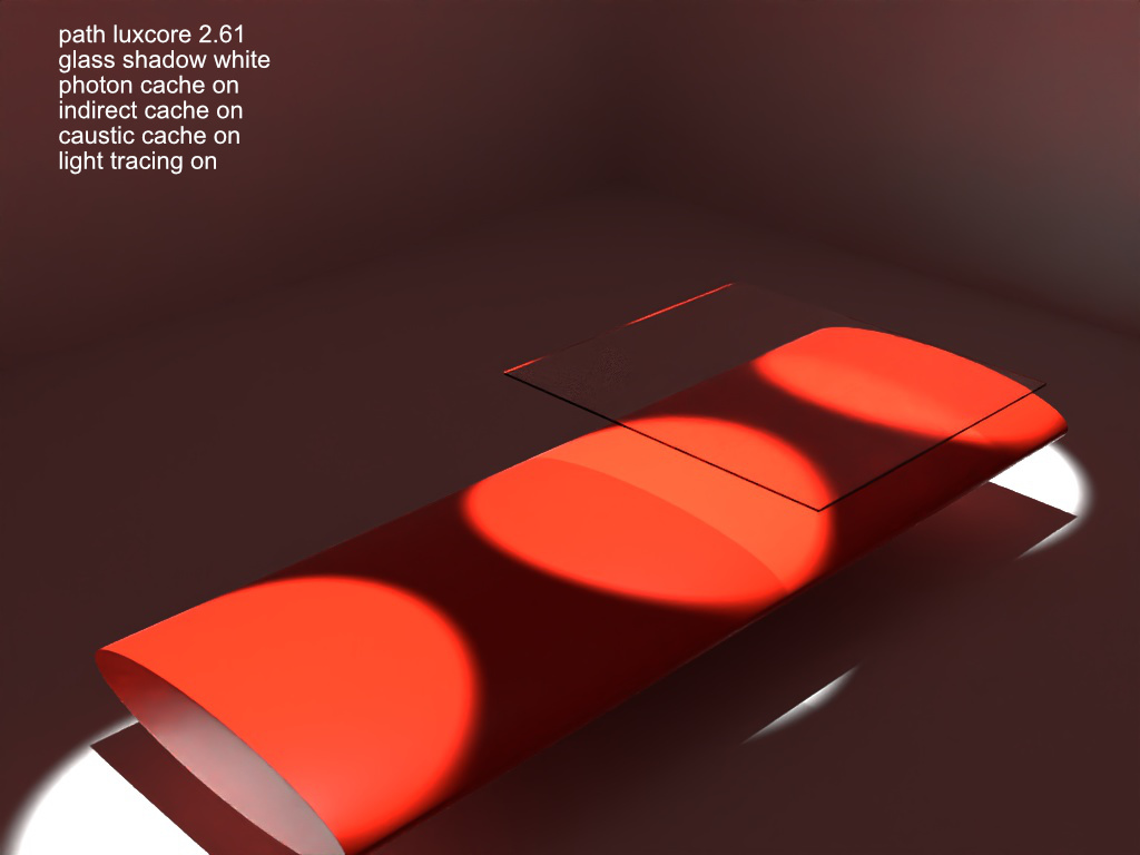

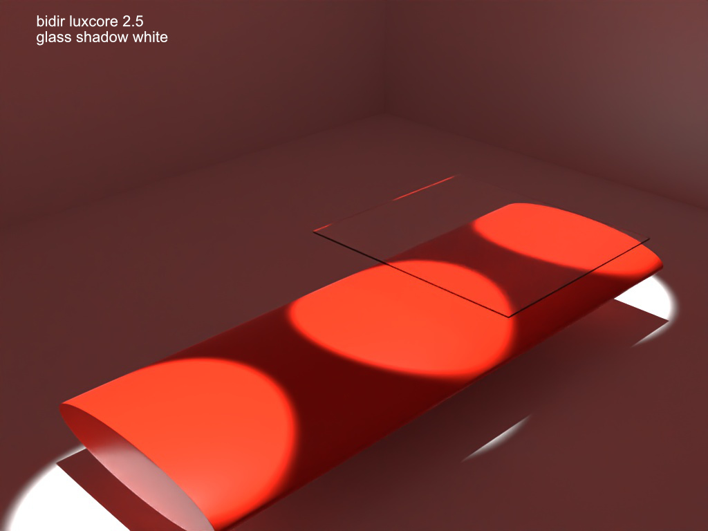

In blendlucore 2.5 using bidir you just need to make the glass shadow color white, it matches the result of version 2.61 using path where the glass shadow is also white and only photon cache enabled(light tracing and caustic cache disabled). In those two examples the glass is not visible at all in the red capsule.
The other two examples that match are both in 2.61 version with glass shadow color kept black ,first one bidir with photon and caustic cache enabled and the second one path with photon, caustic cache, light tracing enabled. But in those two examples there is still some glass visible in the red capsule. See the image below.

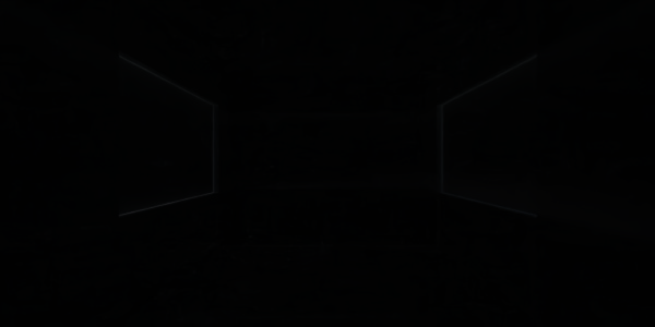

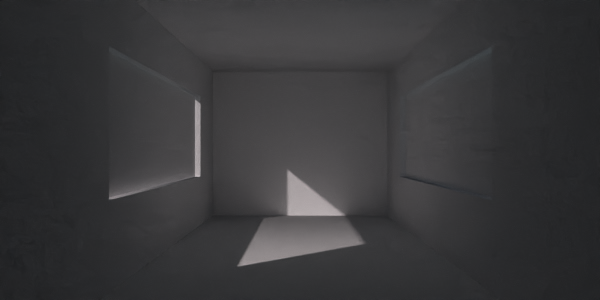

Hi, i created also this scene which isolates the problem with physical sky or HDRI under BIDIR.
No obstacles of any kind in the window
Obstacle with black shadow
Obstacle with white shadow. I would expect the last scenes looking very similar to the first one, letting all direct sun and sky light in. Interesting is also the gradient artifact on the floor.
Please dade help us with this. It is truly important as you see because it strongly affects all interior scenes with natural light.
