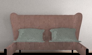

pic of test

Re: PhotonGI cash problem
It looks like the problem is related to the use of constant infinite light, if I replace the light source with an HDR infinite light source, it works fine:
Fu*k, this scene was driving me crazy, I was getting out all kind non sense results.
Your problem is just caused by an extremely low clamping value. If you disable variance clamping (or raise the value by a significative amount). The rendering will be fine.
You were "clamping" a tons of light, this is a rendering with your clamping value:
and this without clamping:
You are clearing cutting half of the transported light (and causing artifacts in the process).
