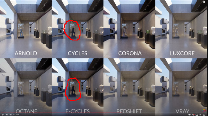

But does the video include any note about quality ? I mean look how the statue is rendered by Cycles and its clone:
I can spot an E-Cycles render miles away: most Cycles renders look like direct light only renderings but all E-Cycles look like direct light only renderings (it is the equivalent of a punch on an eye for me).
Note also as (E-)Cycles is the outlier here (every one else render indirect light).

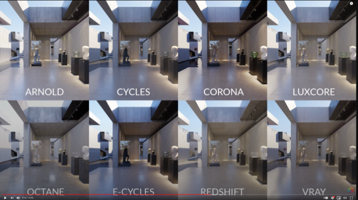

There are many details, E-Cycle vs Cycles is clear that loose a lot of quality, that's what E-Cycles is basically based on.
Now regarding Lux for example you can see how there is a lot more light being computed, its a brighter image.
I've been talking with BlenderBrit about this and how there are fundamental differences between how engines work, like Bounces in lux has a big impact in render time and you don't usually go over 6 or even 8, specially with PGI, while in Cycles or Corona the impact of bounces is waaaay lower, but depending on the situation you may need over 23 bounces to get a proper result comparable to Lux, the same goes for Arnold.
Another example would be Clamping, theoretically is the same, but it behaves differently in every engine, and affects different things, for example in Corona you don't actually really need clamping, they have something (don't ask details) that avoids fireflies and too bright pixels that is embeded inside their algorythm, I know it's not clamping, it's a diffeerent thing because I remember Ondra mentioning it when Clamping was added to Cycles, but Cycles needs it in many situation and it helps to avoid TONS of noise with practically no difference in Lux.
Every engine works differently internally speaking.
