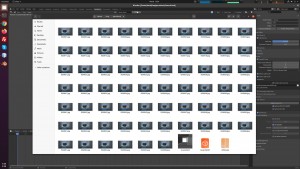

I maybe on a good stream now. Running a second and small low quality test anim to confirm before final frame. :)

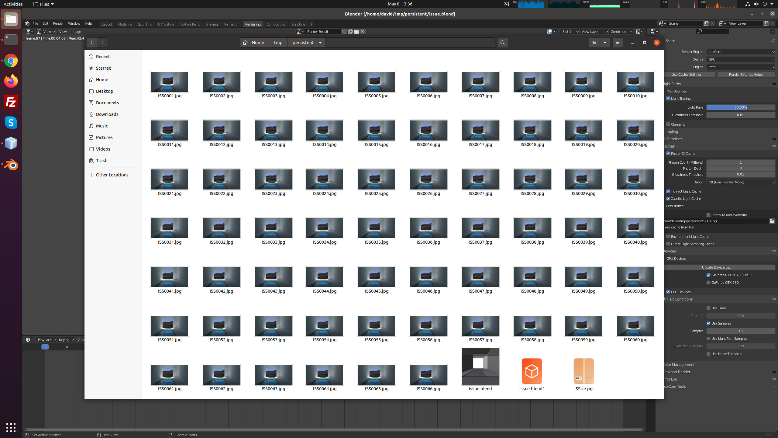

Have you run one frame rendering (to create the cache file) than disabled the "Compute & Overwrite" flag and run the animation rendering ?
You .blend is rendering fine here:

Yes this what i did before but look like at some point the cache was compute withoute Light tracing enable. So enabling Light tracing and reducing the wave size stabilze everything.
I am now rendering the final frames. About that is there a tool to remove the small inconsistency introduced by denoiser ? I remenber in a discussion someone talk about " Temporal something " or " Flicker something"
