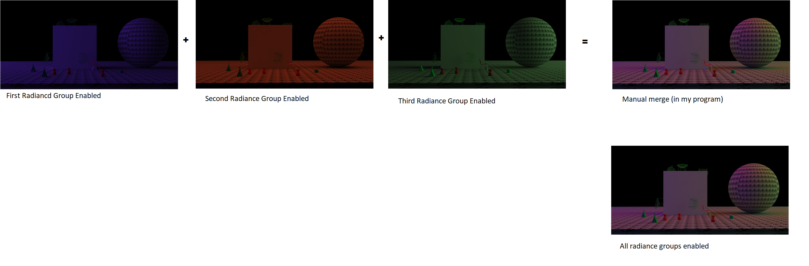

Could you be so kind and explain why I can not merge images produced by image pipelines?
I've done some simple test. I grab 3 images written by image pipelines 1-3 (from previous post). Merge them manually. And than compare to the image produced by luxcore when all radiance groups are enabled. They look to be identical. So where is the problem? It will not work when I will start to multiply them?
