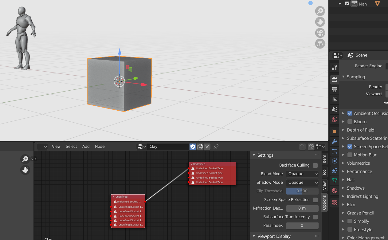

1. Yes. It is properly installed and worked fine before I removed and copied/pasted you have been mentioned files.
2. I removed that files which you posted on your screenshots.
OS: Windows 10 Pro x64;
Blender version: v2.83.12 LTS (latest);
Here a screenshot from error:

Odilkhan Yakubov wrote: Tue Feb 16, 2021 3:36 pm 1. Yes. It is properly installed and worked fine before I removed and copied/pasted you have been mentioned files.
IDK, I think something else is a miss.
Care to check on a fresh, clean, default portable standalone installation just to be sure nothing (old preferences or startup) is interfering.
I've seen that sometimes even installing Blender via auto-installer (.exe) can cause issues.

Really dont know. From other hand I started using SuperImageDenoiser addon by Kevin Lorengel. Here a link if you're interesting:

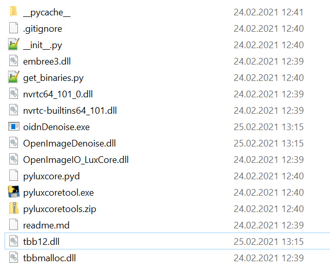

For me it worked. Just delete the 3 files - oidnDenoise.exe, OpenImageDenoise.dll and tbb.dll. Copy the new ones into the directory. The file "tbb12.dll" has a different name now though.

AndreasResch wrote: Thu Feb 25, 2021 1:11 pm For me it worked. Just delete the 3 files - oidnDenoise.exe, OpenImageDenoise.dll and tbb.dll. Copy the new ones into the directory. The file "tbb12.dll" has a different name now though.
did everything as you wrote, it still does not work.
blenderluxcore just turns off :?

Can you post a screenshot of the BlendLuxCore bin directory?
