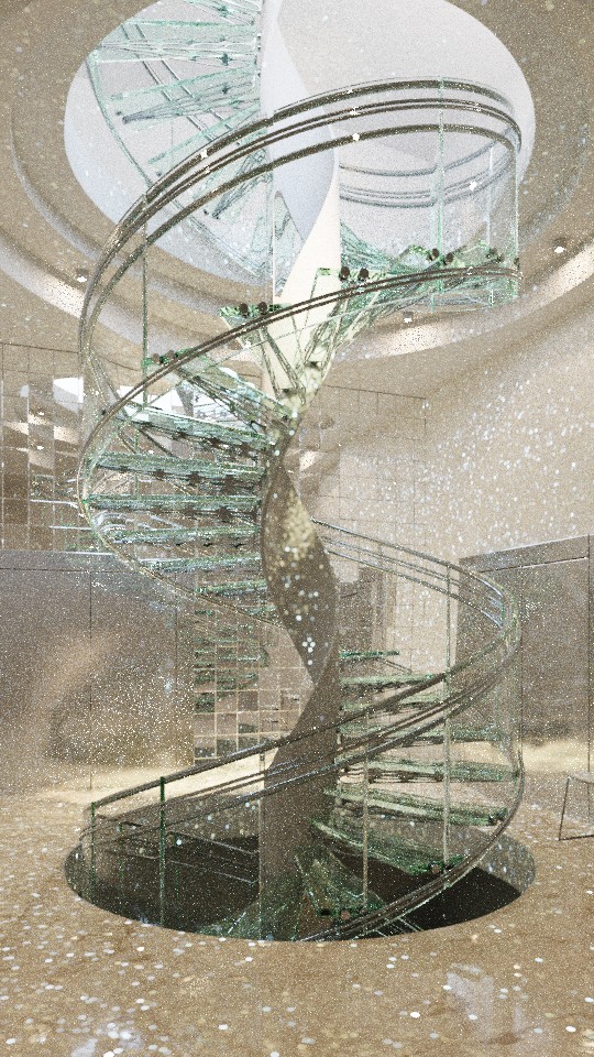

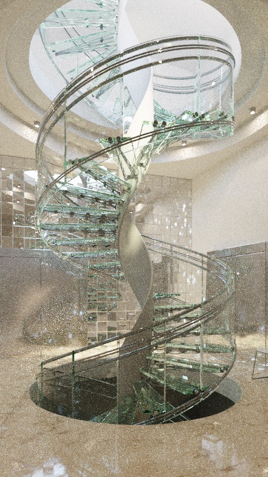

In general it is easy to setup Gaustic cache for pool.But when i try it in an interior scene with mirror glass i am never able to find a right balance between speed and detailed caustics. The more precision i get (higher photon max size / lower lookup radius / higher steps samples) the worse speed can be affected. in the recent benchmark scene here : https://youtu.be/yRJWDotGxvs it was planned to had caustic cache in the mix but none of my settings worked always end up with this :
Fast render = caustic disappear as render progress.
very slow render = photton dot stay frezzed on a clean diffuse surface dot
with the pool it converge easily but cautics cache on diffuse surface stay unbreakable aleast for me :

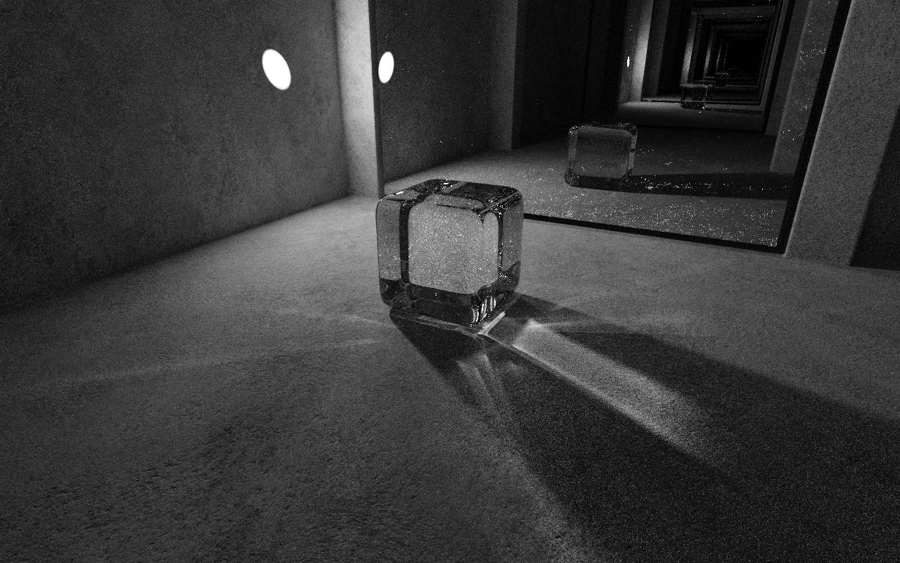

epilectrolytics wrote: Mon Dec 21, 2020 2:25 pm So what about BiDir + PGI cache, can it do reflected indirect caustics as well as BiDirVM?
Now that v2.6alpha is finally accessible I tested this scene again and, as I feared, the caustic cache is limited to SDS paths with BiDir and just slows down repeating the message "PhotonGI metropolis sampler is unable to find a useful light path".
With this restriction in place I don't see much use of BiDir + caustic cache as it does basically the same as PathOCL + PGI which is much faster.
The goal should be to have a complete algorithm that renders all kinds of paths.
(What about LightCPU + caustic cache?)

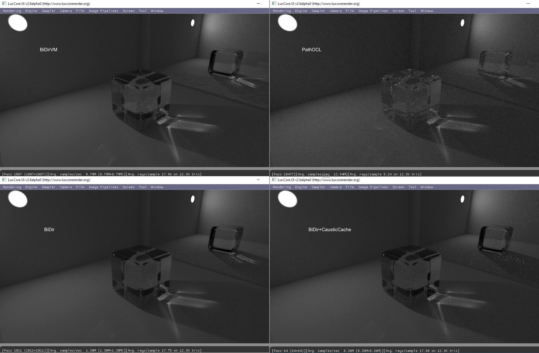

I have been comparing this with some other engines:
To my surprise it is not BiDirVM showing the best result but PathOCL (Sobol) which renders brighter glass bodies.
BiDir, BiDirVM and BiDir+cache (all metropolis) show black areas within the glass while the environment has no black areas, apparently they are all missing certain paths.
(Edit: Obviously I screwed up the light path depth in BiDir. Assumed it was default 10/10 because it is not specified in the cfg but after testing again with 10/10 it looks like the PathOCL glass which is at 12 specular. So the BiDir pics above are not legit concerning path depth but the point regarding DSDS missing acceleration from cache remains. Retesting PathOCL vs BiDir overnight now.

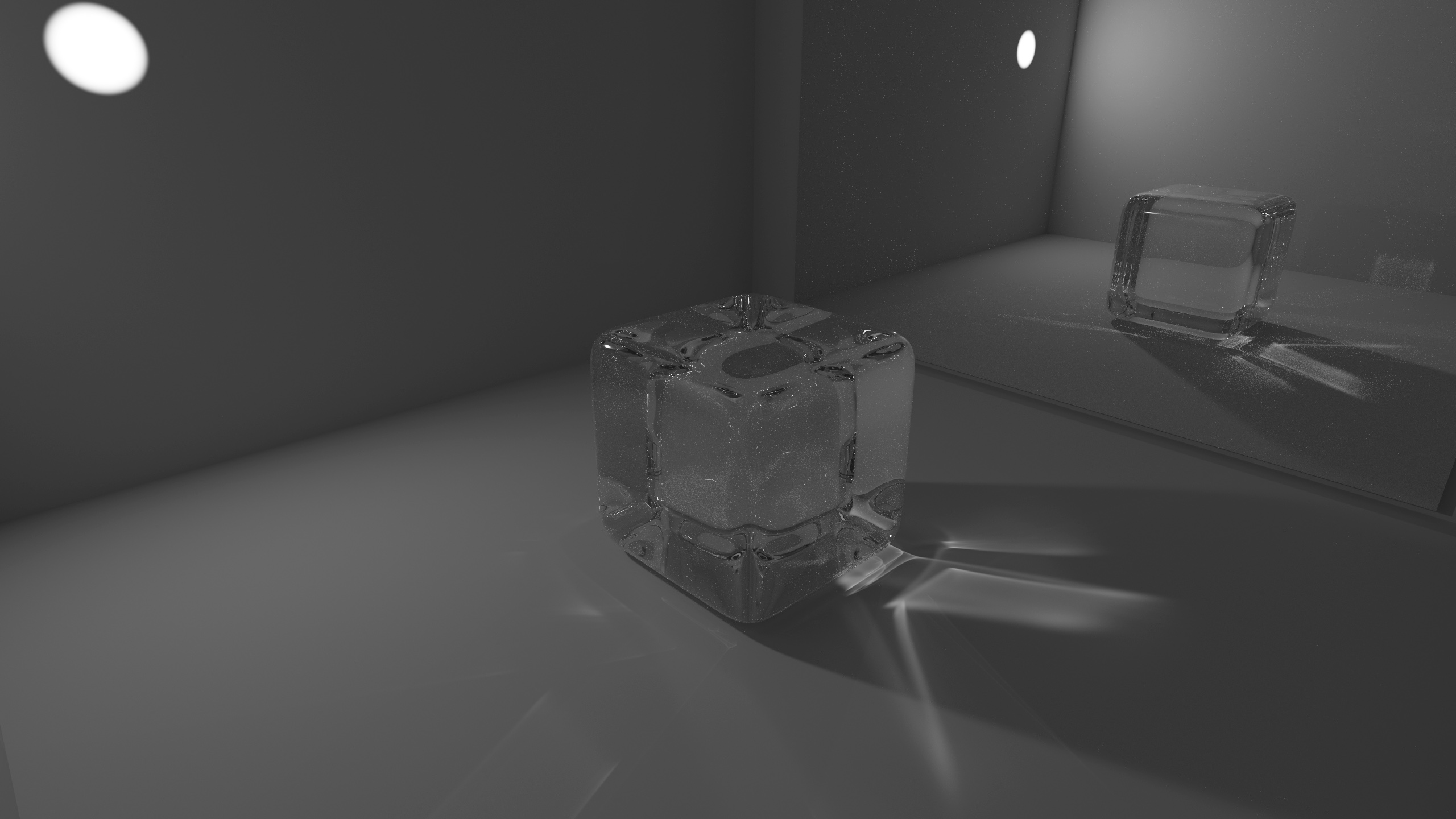

Here is a BiDir render, 10000 samples with light depth 12 and eye depth 6, now the glass looks ok.
But even after several hours of rendering (12 core) the DSDS paths are still noisy, I hoped caustic cache could have accelerated this...)
